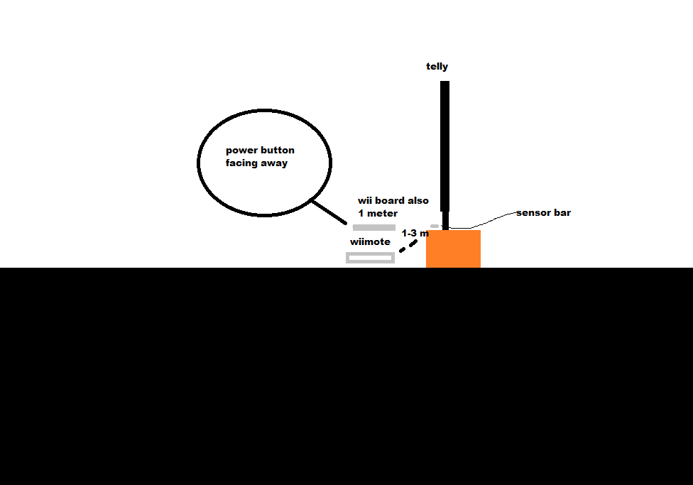

you were putting the wii balance board too close to the wii to sync it.
the manual of the wii balance board says:
the wii balance board should be located directly in front of your tv as shown below, with the wii remote between 3 and 10 feet (1 and 3 meters) from the sensor bar. the power button faces away from the tv.
place your wii balance board about 3 feet away from the tv. then turn the wii balance board upside down to sync it.
So, this:
So, the Wiimote is another factor here?
