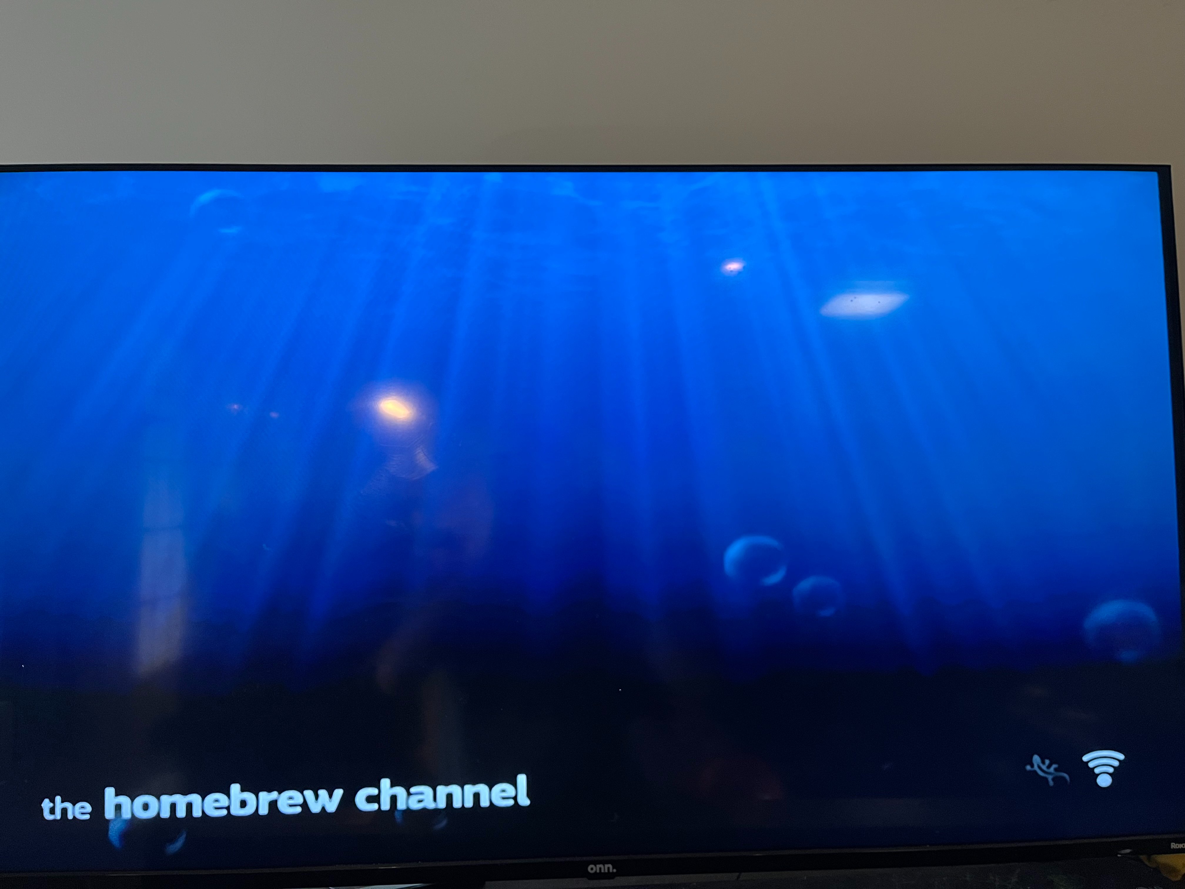

So the good news is the HBC wad worked, I was able to get it in the nand like you said.
HBC opens, and I'm at the bubble screen again with no apps displayed (like before).

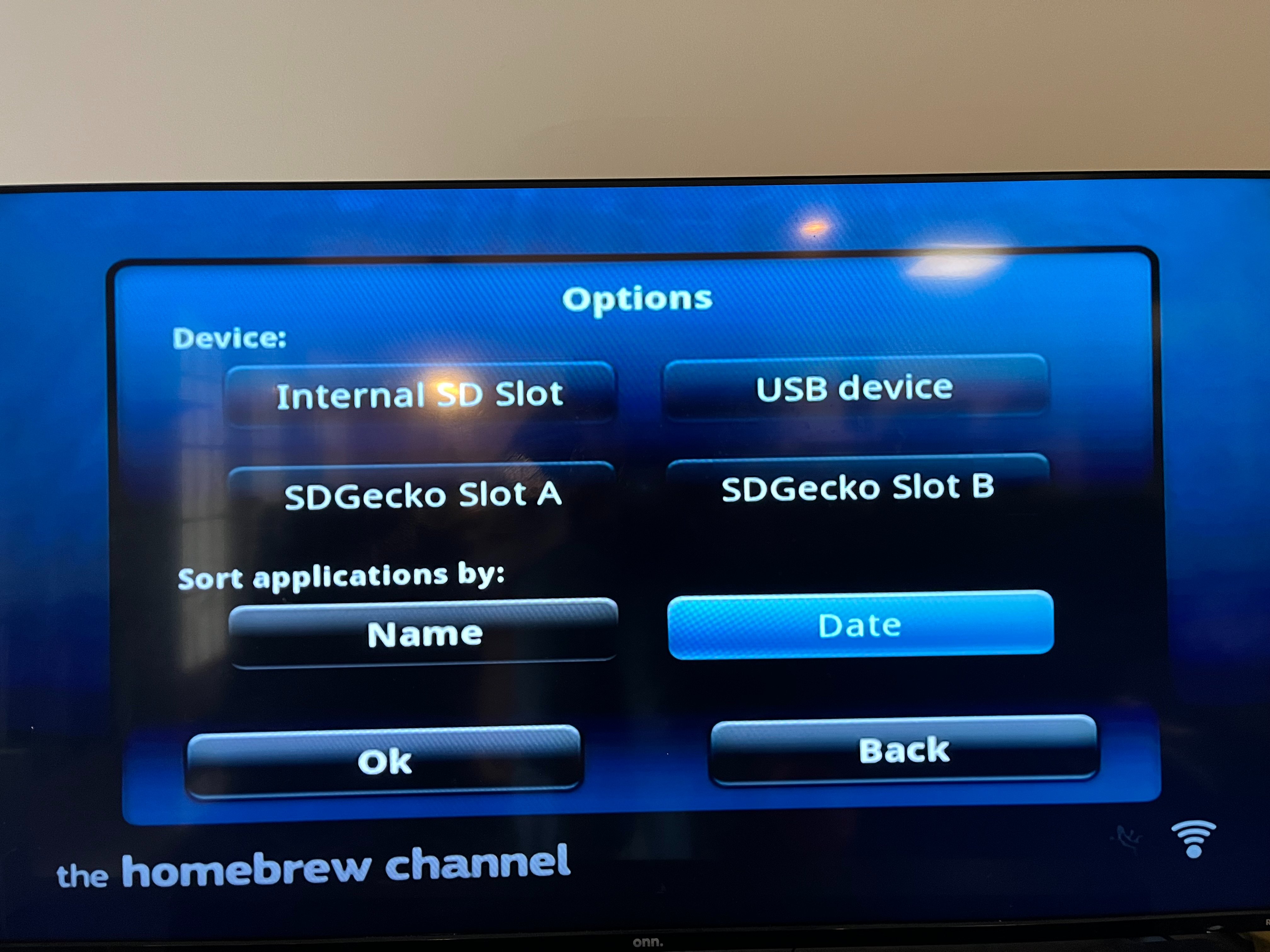

I've got a gamecube controller hooked up, and when I press X, I can see the menu to change the storage device SD Card, USB, but the options are grayed out. I have an SD card in and a USB hdd in port0, the directories are correct (apps folder in the root). And my Wii is not connected to internet since I haven't been able to access the Wii System Menu

I'll admit a degree of senility when it comes to hacking Wii - I've been doing it the same way for years and if it ain't broke I don't fix it. My point is: you're experiencing some weird behavior, and we could be missing something - that we normally take for granted. So I'm going to list some basic information.
The Hackmii installer v1.0 installs HBC 1.1.0
The Hackmii installer v1.2 installs HBC 1.1.2
The HBC Github's latest release is 1.1.4-1
The latest official Wii System Menu released by Nintendo is 4.3.
_____
Simplest potential problem and solution would be if you have been using (and installing via ohne) an old system menu version. Hackmii and HBC should work with any system menu version, but they're understandably far less tested on outmoded System Menu versions. Maybe that was the source of the oddity.
I've never personally used the Github HBC versions post 1.1.2. My understanding is that they were mostly updates for WiiU (vWii) stuff and I never encountered a Wii that didn't work with 1.1.2. I'm guessing that the Github wad is the one you added to your most recent ohne.
_____
If you're really risk seeking and give up on restoring full functionality, I do have a thought. I basically don't go into Wii System Menu on my Wii. I use Wiiflow (USB loader), which launches on every Wii boot via Priiloader. Wiiflow can launch homebrew (like HBC does) as well as games (like System Menu does).
So a very wrong way to do this could be to give up on System Menu and HBC, install Priiloader (via bootmii), and set Priiloader to boot a USB loader (or similar all inclusive software) off the SD card/USB on every Wii boot.
This might not work at all - whatever your problem is could potentially also foul up any of the software I mentioned. I recommend keep trying to get HBC and System Menu working. I just figured you might want the reassurance there are crazy stupid alternatives.
