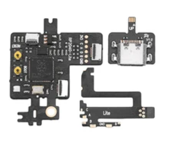

After reading quite a lot and watching videos on youtube, i decided to install a chip in my Nintendo Switch Lite to jailbreak it.
There seem to be quite a lot of different chips out there.
This is the one I have.
One of the problems i have is I don't know what this chip is called. People seem to mix the names a lot.
Is it a RP2040? Is it a Picofly? Is it a HWFly? No clue at the moment....
I have put picofly firmware on it version 2.7.3 (Ansem-SoD/Picofly/tree/main/Firmwares on Github)
After soldering, i tried to turn on the console. The console boots in the official nintendo firmware. The error code on the chip is 2 short flashed.
(** RST is not connected)
So i guess i have somewhere a bad soldered point.
Can someone point me to the mapping of the letters? I have to solder A, B, C, D and 3,3V on one of the cables.
How do those points map to RST, CMD, D0 and CLK?
I would also like to know how i can measure if the different points are correctly soldered.
Do i need to measure the voltage levels on each point when the battery of the switch is connected? What should be the values?
Thank you very much already for your time.
