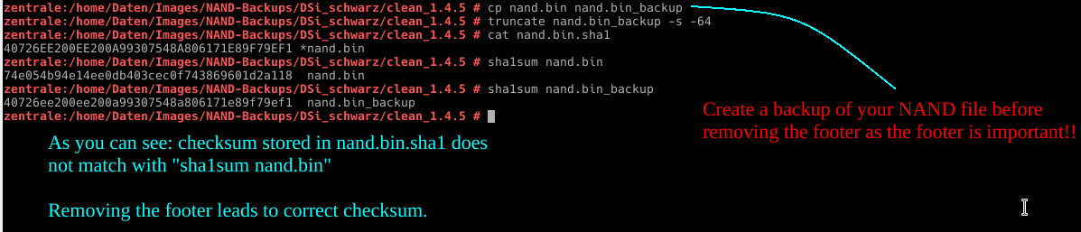

Hello, i have an issue that i like to clarify before i proceed to install anything:
I have dump my DSi nand twice and both times SHA1 reported by FWtool is different and also running a sha1sum on my linux os i have found also different SHA1 than FWtool
1st Dump:
FWtool sha1 -> BB3A584361695C8EF5BDEA50A707088CC07F9E6C *nand.bin
sha1sum nand.bin -> aea2f654d9f1fdcd3c2f5da76af7a47e1ae6bd44 nand.bin
2nd Dump
FWtool sha1 -> FC187AE3489A44A2AFC9801D17D89815AED663 *nand.bin
sha1sum nand.bin -> 9aaea9a72614db7c406f5e4138735eec8b18b70f nand.bin
Any info would be appreciated

The sha1sum is calculated from the actual NAND by fwTool.
After that the no$gba footer is added to nand.bin
If you type sha1sum nand.bin your computer calculates the sha1 for a larger file; 64 bytes larger than the NAND. Truncate a copy(!) of nand.bin and get sha1 of this copy:
But checking the SD like @zacchi4k suggested is always a good idea.
