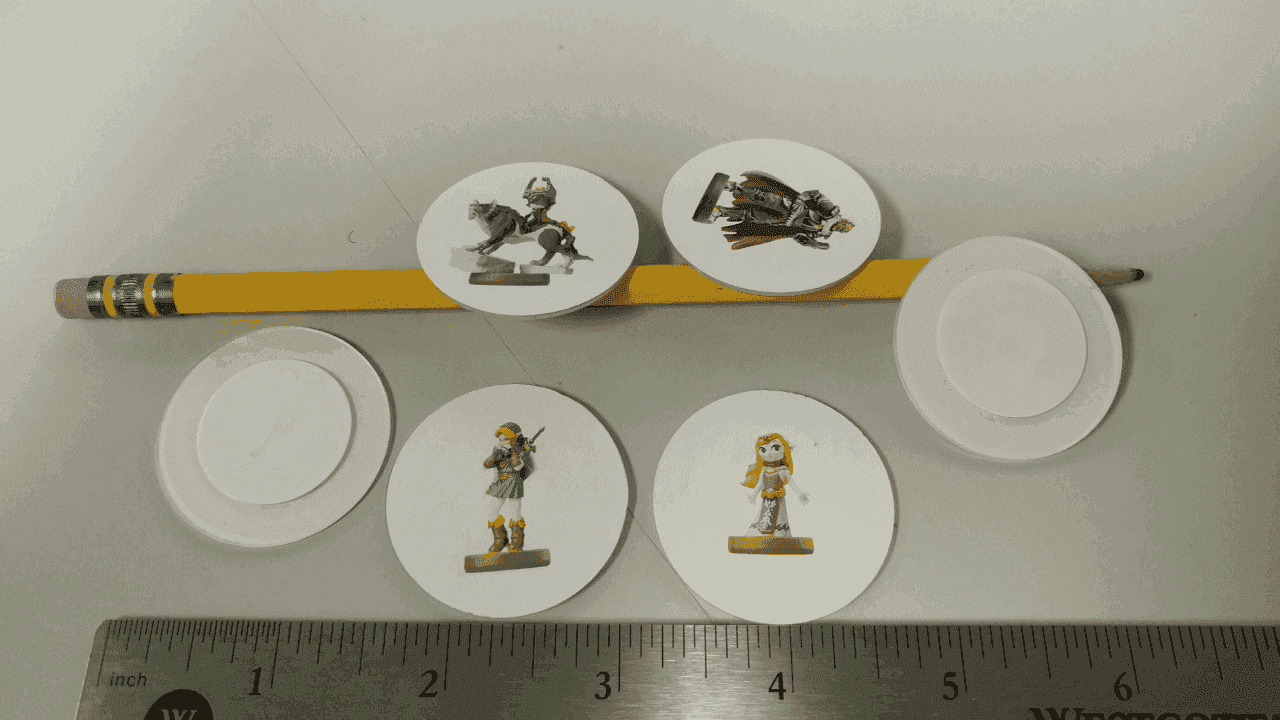

Well, got my custom Amiibo Discs goin' now!! Took forever to get all the items I needed to start making these. They are 1.5" x 1/32" Clear Acrylic Discs with 1.5" color printed labels on one side and the 0.95" round NTAG215's on the other. I thought about doing 1" discs since the NFC tags were just under 1" but then the printed graphic was too tiny to make out a lot of detail. Besides, now I could drill a hole in each disc if I want and put sets on a cord loop or keyring. They entire Zelda set for BotW (17 Amiibo in all) fits nicely in my Switch case too.
What do you all think?

seems a lot of work but good job.. looks really neat.. but for me i prefer coloured discs like Link from SSB you use a green disc, or Zelda BOTW amiibo a dark blue or black.. but still this is a really fine job..wish i got the skills, or patience..im too lazy i might just use a permanent marker to determine which is which LOL..

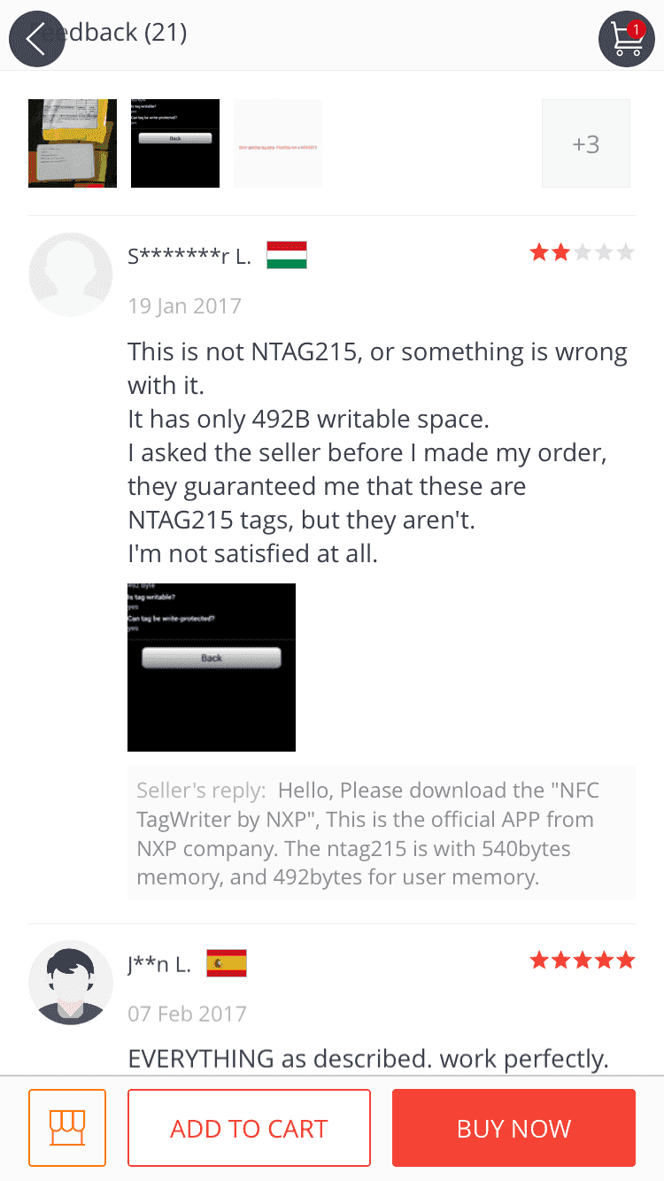

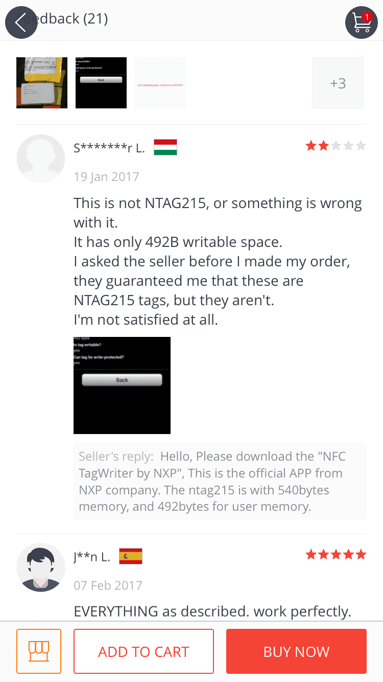

@killmister2 , regarding that nfc card, i saw a comment where it says it didnt work? now im having second thoughts about this..

Thanks. I did permanent marker on the NFC paper backings until the discs showed up. :D
I agree with you tho about the colors. I wanted to do series in colors like the bases are. SSB in gold, Mario stuff in red, Zelda in green, etc. Problem is it's hard to get the discs in small quantities of colors without buying a random rainbow pack and it would really mess with my OCD if I was short on a color. I tried for white but clear and black were the common colors which translated to "cheap".
I saw this and now m having second thoughts as well.

odd number of bytes. I think it is a somehow damaged NFC TAG 215. Doesn't mean the seller lies.

The NXP app only read the specs of the tags.
i havent got the blank tags yet but seeing that nxp app it looks useless for what we want it for.. glad it worked for you. i might go ahead and order it.. hope it works for me too..
Of 38 tags of 100 i written to, i got only 1 bad one. So don't worry to much.

In conjunction with what @killmister2 said, and for the sake of setting your mind at ease, I ran the NXP app and read one of my blank tags that did not come from that link, but works properly with amiibo. That tag also reports 492 bytes in that app.
:D
I don't think I'd call it an 'issue'. 492 is the max URL you could put on a 540 mem / 504 user mem / 492 URL / 490 txt NTAG215.
thanks, i was a bit worried. But now it seems my questions have been answered. I'll go ahead and order some more. :) by the way, im curious what your custom amiibo card looks like, i mean did you print a custom design on it to make it look unique? you dont really have to post a pic if it's a hassle for you. You could just describe it to me. Anyway, thanks again. :D
