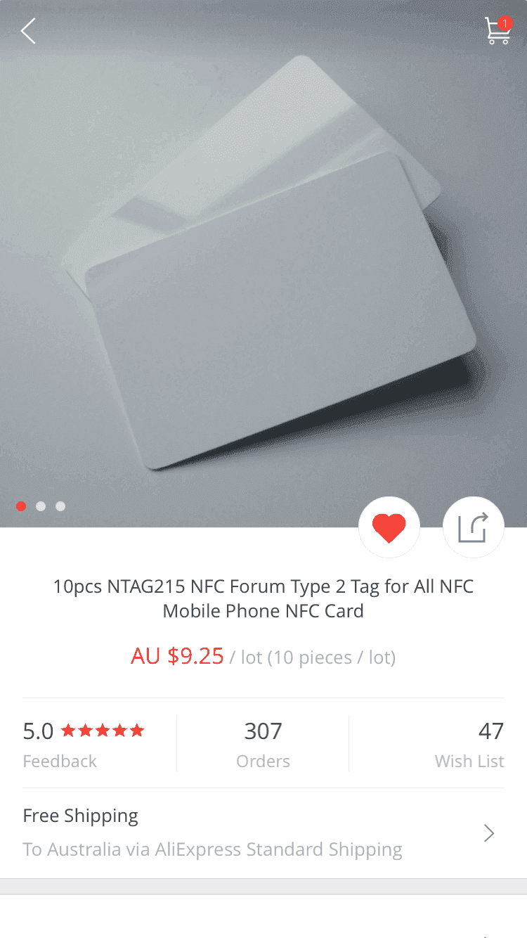

Anyone got a suggestion where to buy cheap nfc tags that can be shipped easily to Austria? I want to buy like 50 tags.
Cheapest would be ordering directly from china, but if you want them sooner for just a little extra I recommend http://zipnfc.com/ (they also got a shop on amazon.co.uk and ebay.co.uk).
edit: dang, they seem to be out of stock for the 215 now
https://www.aliexpress.com/item/NTA...able-NFC-Adhesive-Labels-Dia/32764597031.html
