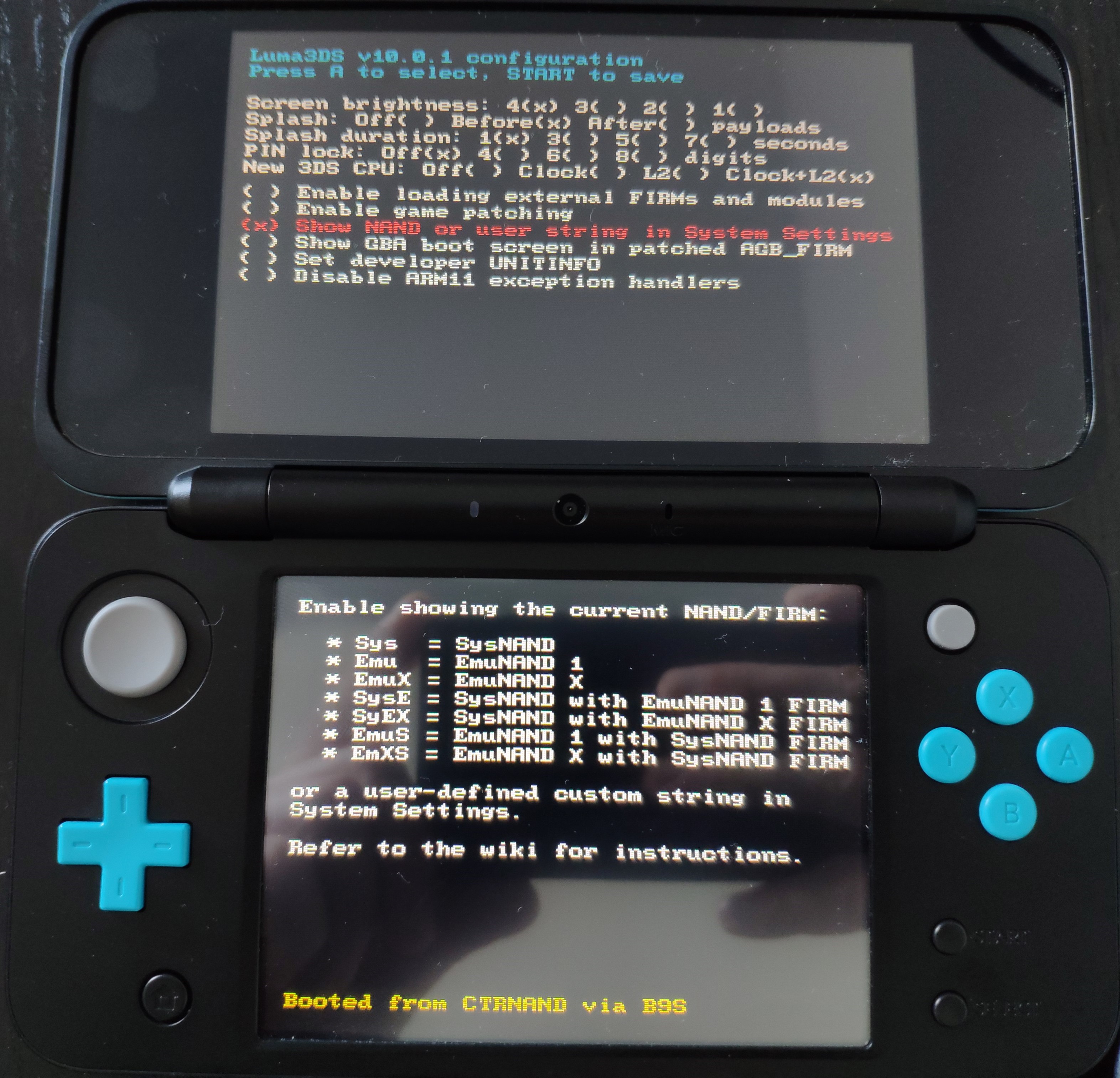

Hi,
i start my new 2DS XL after a while. So i read something about a new Luma3DS update.
So i download 10.2.1 and unzip it. After this i put boot.3dsx and boot.firm on my sd card and overwrite the old one.
Update to 11.14 and after this i get a error.
undefined instruction ?!
When i boot with power + select ther is still Luma 10.0.1 ... wtf?
How i can fix it?
Or is there another way to update Luma3ds? Because i read something about "B9S" and "CTRNAND". I buy it from eBay new with CFW a few years ago. So i dont install the CFW :/
Pls help me. I hope it is not damaged? :(

See the bottom screen of the first screenshot. It says "Booted from CTRNAND". This is because your 3DS is not being able to read the SD properly, causing it to fall back to the boot.firm in your NAND. Check that your SD is inserted properly, etc. If that doesn't work, generally copying everything to your PC, formatting the SD to fat32 and then copying everything back can fix the issue. Otherwise you should look for SD card errors with HW2test.
I try it directly at home. Hope it work
After i backup all my Folders and Format the SD Card new... Luma 10.2.1 starting from SD.
But now i got a Problem that the menu tell me no connection for the SD Card?
Cant access... How i can fix it?? I copy all my Folder 1to1 back to my nw format sd card
It would be good if you check for the health of the SD card, following this post, after all
And also, to avoid the same error when SD card is off, please follow the Luma on CTRNAND tutorial (in order to also update the Luma version that your console have right now on CTRNAND)
