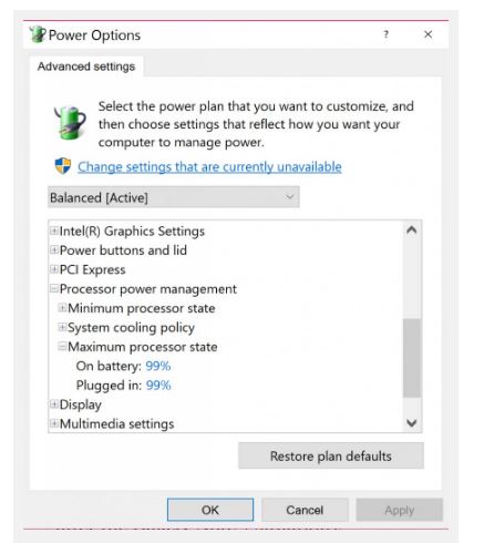

It could be coil whine from the processor, Kaby Lake processors do suffer this issue, you can try reducing the maximum processor state in the power options and see if it helps.
Regards
Megazoid2k
