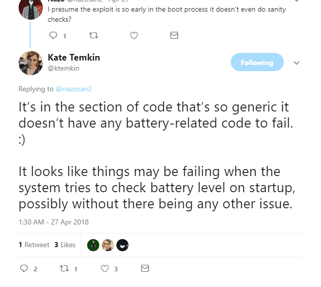

https://twitter.com/ktemkin/status/989782397431332864 That part I was talking about is on this thread. That's how I knew that.
From that thread Kate herself says that there should be no battery code:
I'm sorry but I must ask, if it's that required, then how the hell does someone boot up a switch from a completely dead battery. If it's that dependent, shouldn't store some power first and then turn on?
It works because you have a charger plugged in and thus power, when a charger is plugged in the Switch will boot without pressing power, so that should be no problem as the "charging code" is loaded immediately.
When we are talking RCM the PC can't supply enough power to reliably keep the Switch alive if the battery is truly dead, so getting to a chargeable state can be impossible.
