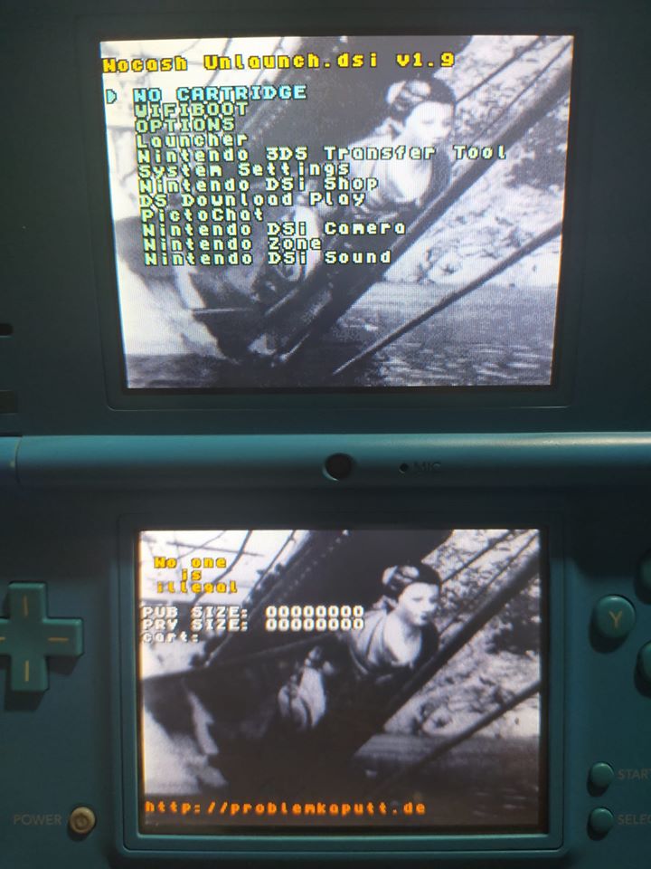

Hi I need some help. Mine doesn't show the Uninstall option anymore. For some reason, I can't upload the image of how it looks like.
Hi I need your help. I have the unlaunch dsi v1.9 and doesn't show the Uninstall option. I have removed all the files on my SD Card and kept the unlaunch.dsi file.
Please I want to fix this ASAP.
Thank you!
Thank you!
Launch into the unlaunch.dsi file. It should have the uninstall option there
