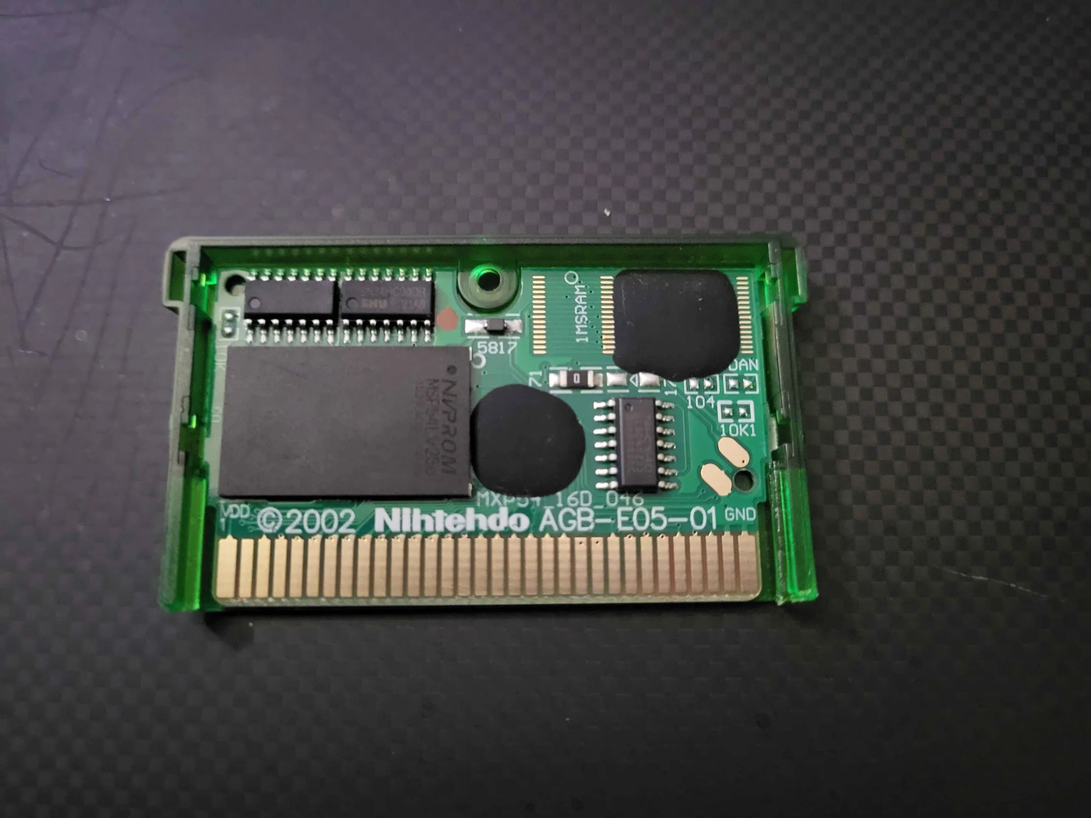

i bought one that is made with that exact design. you can easily tell by the board layout.
it came on a transparent shell, i put it into this green one from another cart that was one of those batteryless save patched trash and of an older romhack version to begin with.
this one has 128kb flash and no clock, that is fine as pokemon clover doesn't use it.
it works perfectly fine and flashing it with my joey jr. was as easy as always.

Pokemon "Quetzal" version from Alixpress worked for me with FlashGBX. SRAM patched with Lesserkuma's tool here, and a new version of FlashGBX that is pre-release. I'm not sure if this functionality is baked in to the current version, but worst case wait a bit until the next version.
I was able to successfully burn Leafgreen to the cart. Saves and functions perfectly. No Solder bridge was needed. No RTC but less than ~$6 USD shipped.
This is what the PCB for it looks like-
this is a SRAM Based cartridge that will also need you to solder a battery to it for the actual SRAM to be used correctly,
otherwise you can only use this as a batteryless sram patched cartridge. (will not work with Pal Park / DS linking)
different sellers sell different style cartridges, I cannot confirm what seller sells what cartridge as my last orders were about 6 months ago and I am not in need of any other Flash based cartridges
