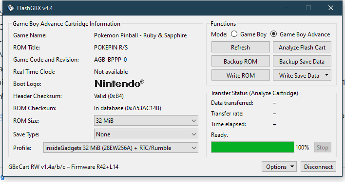

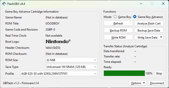

I'll try to find the thread you mentioned. As for the "Analyze Flash Cart" option, it's the same one shown in the image above.
ROM Size:32 MiB
Save Type:None
Profile:insideGadgets 32 MiB (28EW256A) + RTC/Rumble

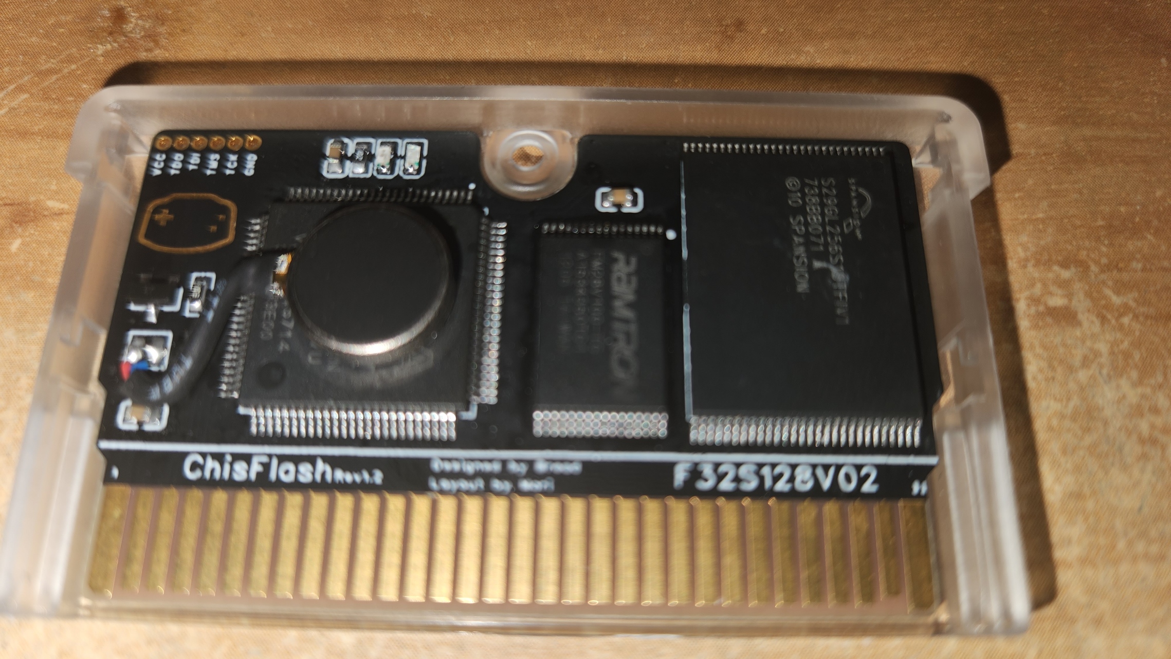

ok, I have purchased from this seller before, I will post the images and results of the purchase when it arrives, it has landed in Australia already.

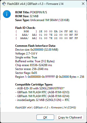

this is when loading the cartridge in FlashGBX

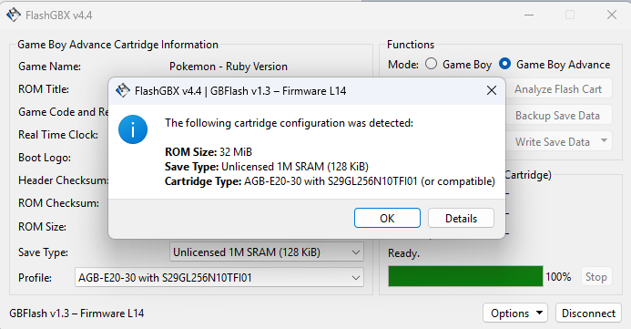

after clicking Analyze

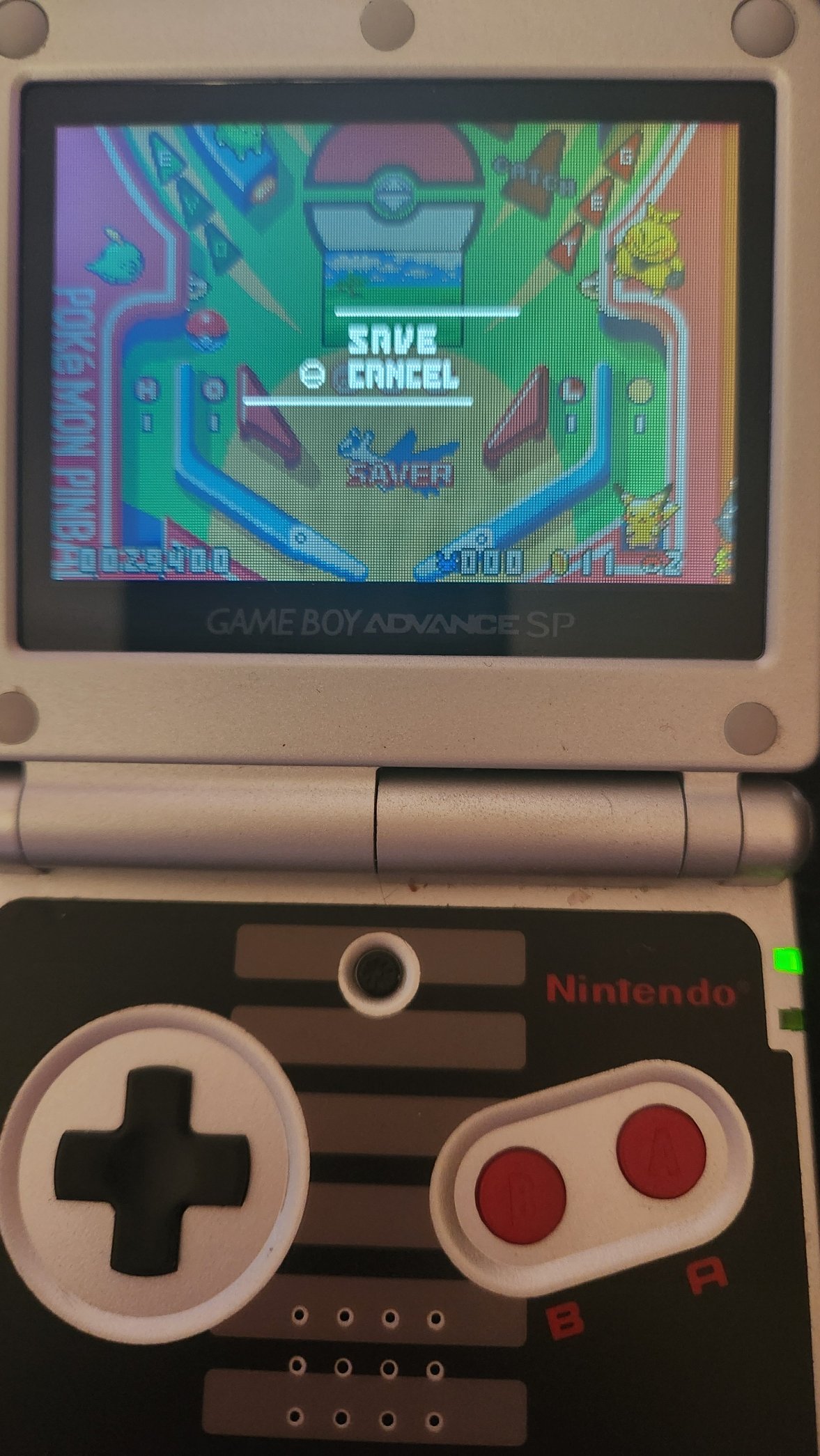

after writing the same rom.
running SRAM test
game is working perfectly
the game does not have rumble enabled, you need to patch it with https://www.romhacking.net/hacks/6256/ also to get rumble working
works perfectly after that
if your cartridge is still reporting no save, try force the save type to 1Mbit unlicensed SRAM then write a 1Mbit save to it (a pokemon save) then run a test on that

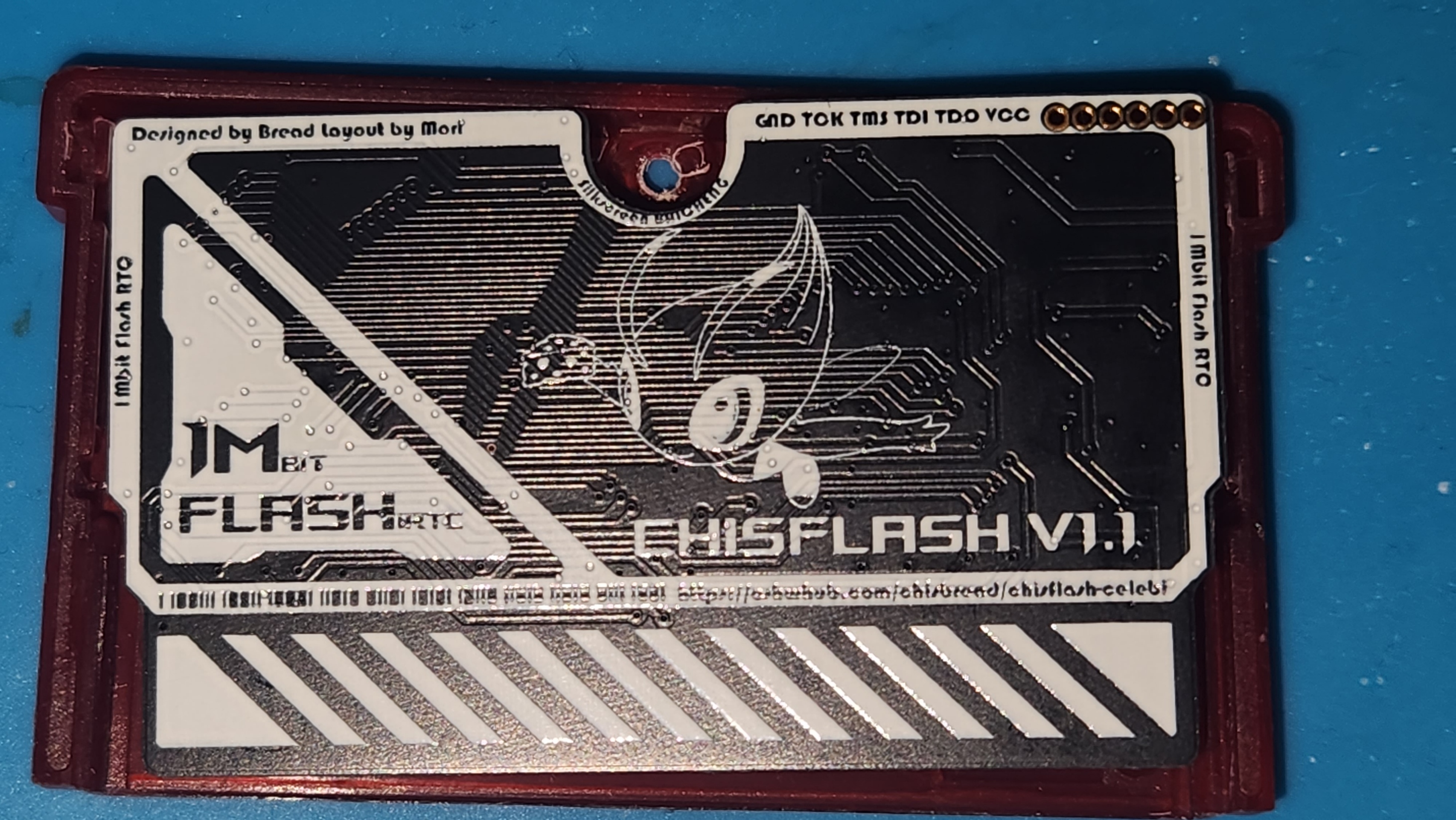

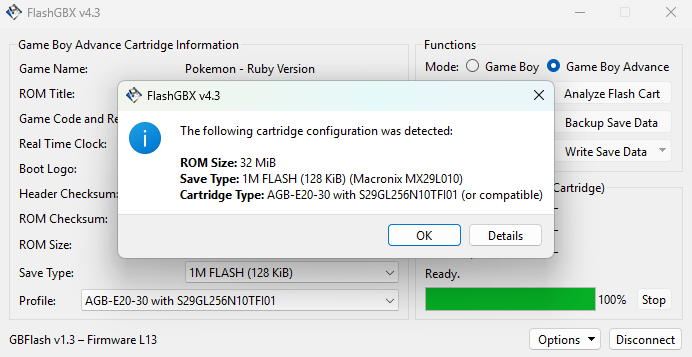

hi friends.. I have one chisflash ver 1.02, I tried to flash pokemon ruby, but when I try to save it says that the save is corrupted.
am I doing something wrong?
this is my flasher:
the game needs to be patched with a custom patcher, not gbata for 1M Flash to 1M SRAM
https://github.com/bbsan2k/Flash1M_Repro_SRAM_Patcher
also note the RTC(timer) will not work on this cartridge
oh, nice! I tried with gbata but didn't worked, I will try with this one tonight and update the results
thanks!

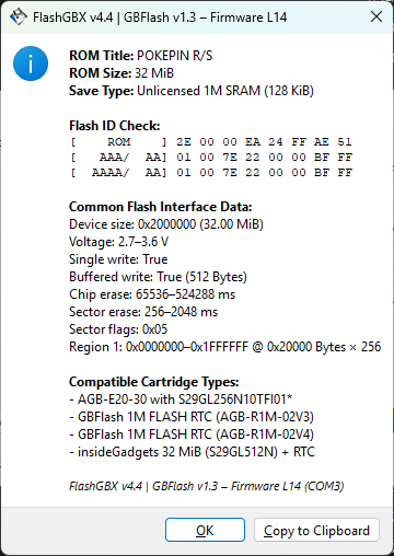

didn't worked, my card is the same as your print
the game boy logo appears, after that white screen, but on pc emulator the rom is ok after the patch
the save type, is unlicensed 1m sram 128kib corret for pokemon ruby?
just an update, I tried this site:
https://gbarompatcher.com/
the game boots, and when I do save, it freezes and there's two leds, one orange and one red blinking, but nothing happens
any hint please?
