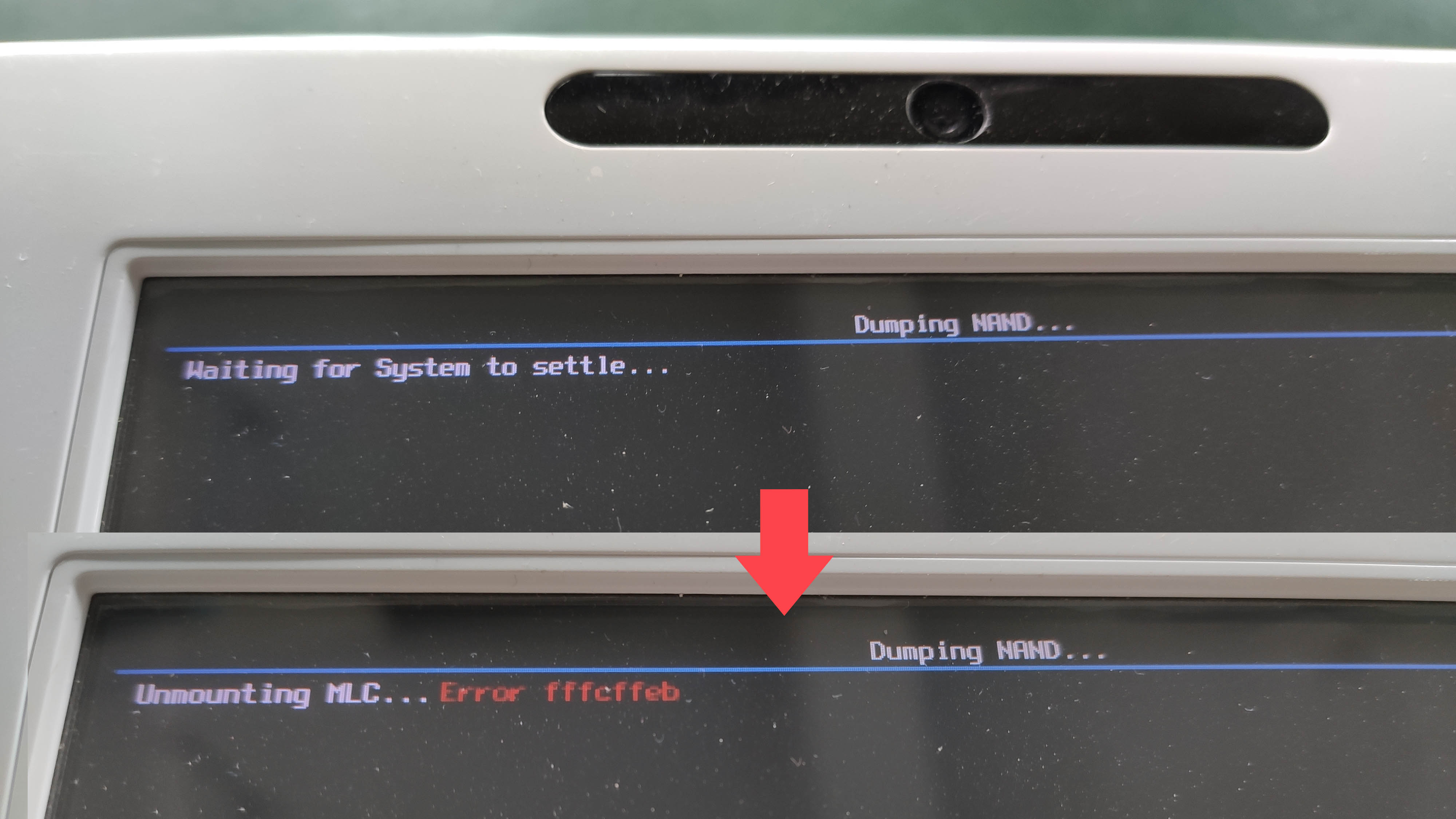

I used the old modfied recovery for dumping and received this reply, and the console will get stuck.
I can't waste too much of your time, SO I'll put this console aside for now, maybe well try using de_ Fuse rebuild MLC later.
Thanks ! :lol:

Just wait a little longer till you start the dump. Maybe the mlc was still accessed and thus preventing the unmount
I just successfully dumped MLC ,have no errors(errors 0,bad sectors 0).
