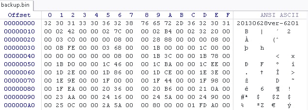

i own this R4 (not my photo) and im trying to get rid of the timebomb on this card but cant find the kernel. please help

The timebomb is only kernel deep, which means replacing it with TWiLight Menu++, YSmenu, or both, which will fix the timebomb issue.
I personally use TWiLight Menu++ with nds-bootstrap on my R4i-SDHC
