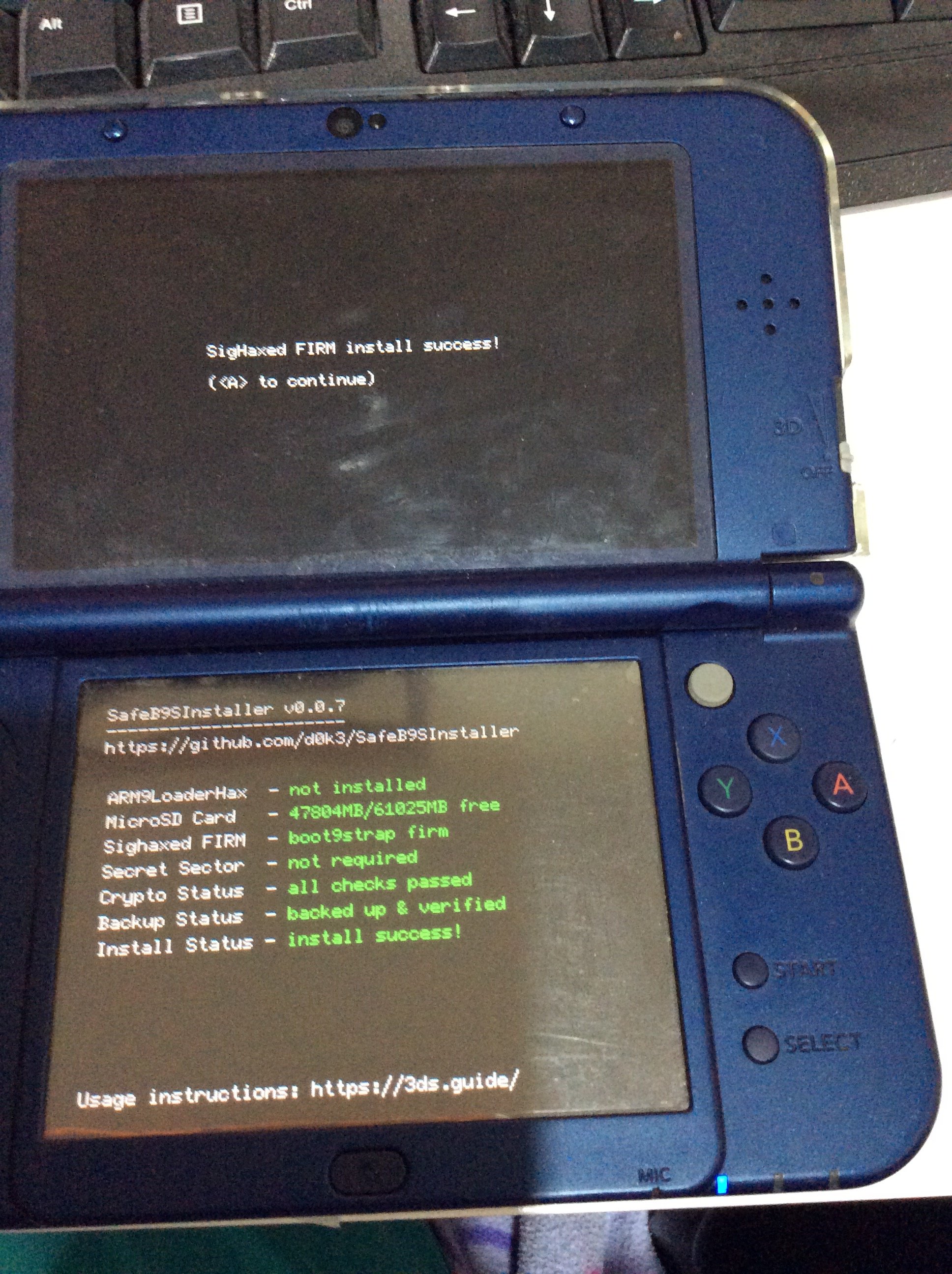

Managed to :
reformatted SD card
Rename SafeB9SInstaller.firm to boot.firm
(Power)(start)
:>SafeB9SInstaller v0.0.7
BUT there are 3 not correct as
ARM9LoaderHax NOT INSTALLED
Sighaxed FIRM. Boot9Strap firm
Secret sector. Not required
And the program keep repeat running when press A
PLEASE HELP : how to safely turn off DS as
SigHaxed FIRM install success!
<A> to continue
Then it rerun again

Managed to :
reformatted SD card
(Power)(start)
<A> to continue
Then it rerun again
The 3DS reboots when you press A, just hold power to turn it off instead.
Looks like you got it updated correctly, so just continue with the updating B9S guide, and remember to put the latest Luma (9.0 I believe) back on as boot.firm.
