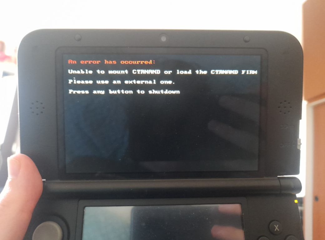

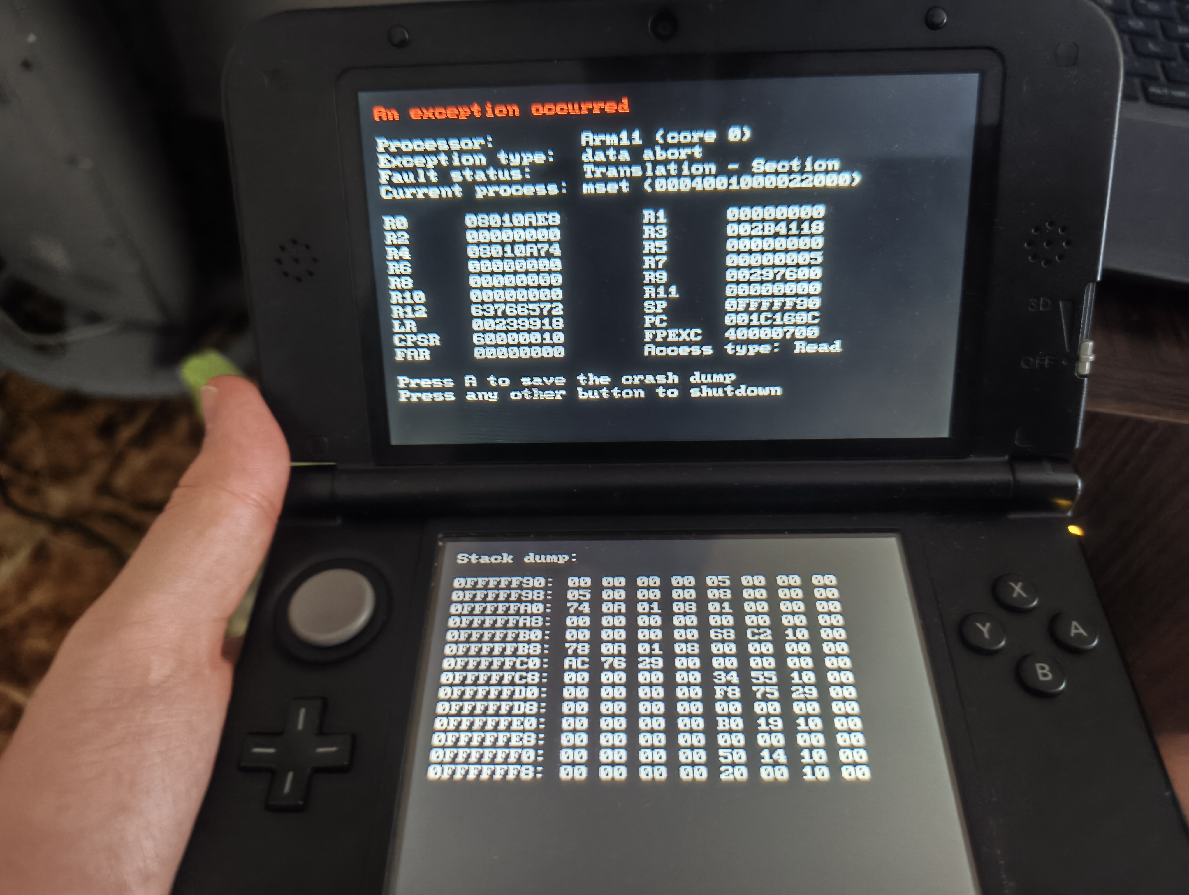

Hello, I hope we can resolve this issue together. Here is what happened from the beginning: I wanted to play DS games directly from the Nintendo 3DS HOME Menu using ROMs, without having to open TWiLight Menu++ every time. Downloading the games and using NDS Forwarder went smoothly without any issues. However, when I tried to launch a DS game, it threw an error. I asked Gemini for help, and it had me follow numerous troubleshooting steps, from uninstalling and reinstalling all mod applications to deleting specific folders from the SD card. Gemini mentioned the main issue causing the TWiLight Menu and DS game errors
as that the 3DS couldn't complete system updates, which is true because when I go to System Settings and try to update, the system says it is unable to perform the update. After spending over 6 hours trying to fix this following those instructions, here is my current status: when I go to Console Settings it gives me the first image, and when I open TWiLight Menu++ it gives me the second image. I really hope this isn't a serious issue and that we can solve the problem.

The first image shows a known error that appears when System Settings is broken. You can try if a normal update works by booting into Safe Mode. Hold L+R+↑+A on power on.

If you do a Google search for [3ds exceptions] and actually take a moment to read the results instead of relying on Gemini, you will see https://wiki.hacks.guide/wiki/3DS:Error_screens/Luma3DS_exception_screen, more specifically https://wiki.hacks.guide/wiki/3DS:Error_screens/Luma3DS_exception_screen#mset_2 .
Did you try https://wiki.hacks.guide/wiki/3DS:Ctrcheck already?
