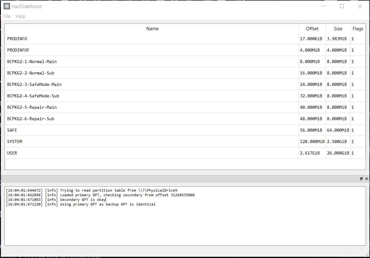

Lol man... i got to 99% dump then freeze it didnt even try to verify cause i never made 100% Not the sd card , i even try booting hekate without the sd in, like you can on other switches, here wanna see something funny..
No errors thats pulled straight from switch, and ovb the dump at 99% error'ed in hacdiskmount
Lol man... i got to 99% dump then freeze it didnt even try to verify cause i never made 100% Not the sd card , i even try booting hekate without the sd in, like you can on other switches, here wanna see something funny.. View attachment 143943No errors thats pulled straight from switch, and ovb the dump at 99% error'ed in hacdiskmount

At this time im manually dumping partitions within hackdiskmount

STrange tho listen to this i just dumped the partitions in hackdiskmount,, just finished dumping safe partition.. and guess what i thought id try hekate 3.2 again well fck me it booted, im going to try to boot into stock.
