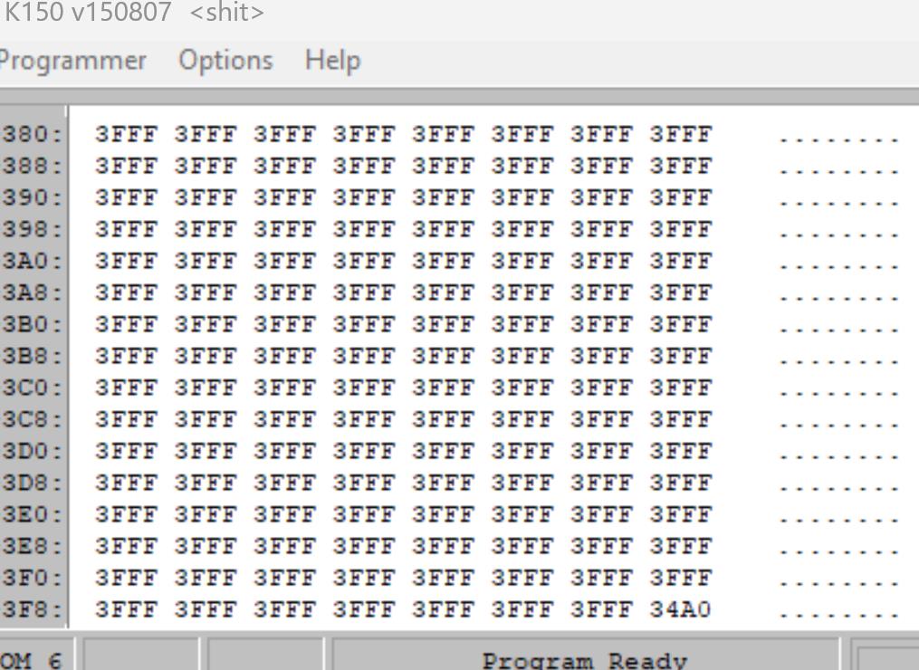

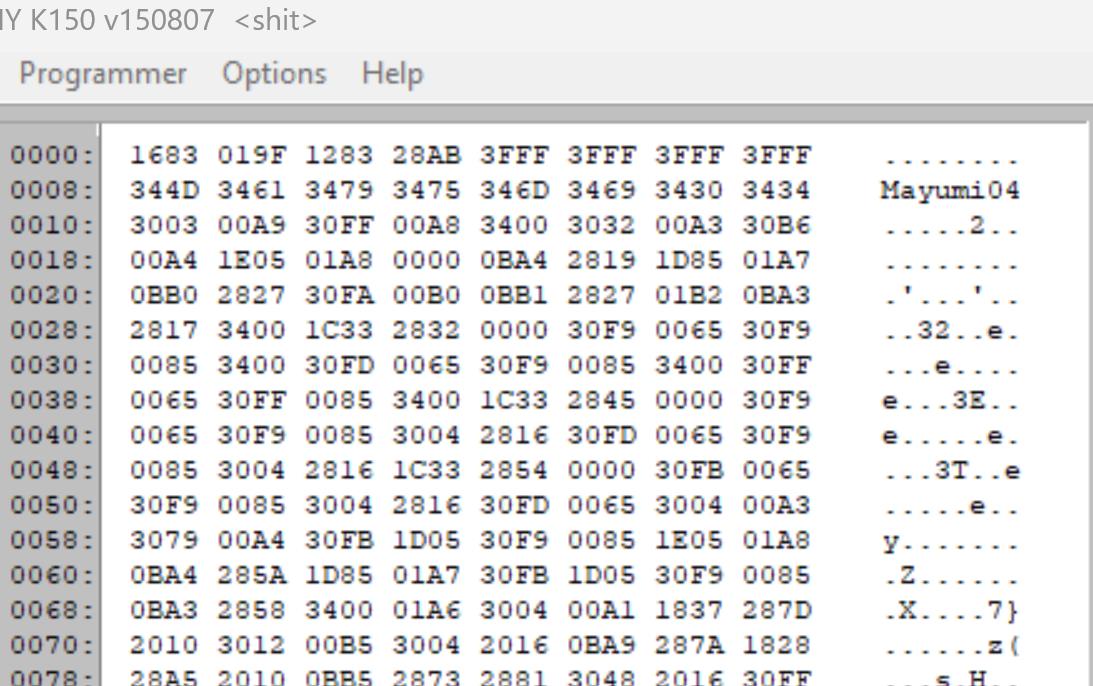

here is the hex dumped from my 12f629
it's in the shit.zip file linked below.
i used both a k150 pic programmer and a tL866ii plus to erase and write to it multiple times with no success in getting a backup to boot,
it seems to match the original except the oscal value which probably isn't needed with mayumi v4 but i tried it with and without the value to no avail.
any advice is welcome, i would like to successfully get this going.

Mayumi 4 write protects the chip after you wrote the hex, meaning that it cannot be reprogrammed. Before programming the chip, you must ensure that the OSC (oscillator) value always remains the same, do note it down in case it ever changes, so then you can change it back to the default value afterwards.
I've had success with my TL866II Plus and I didn't need to change anything beforehand.

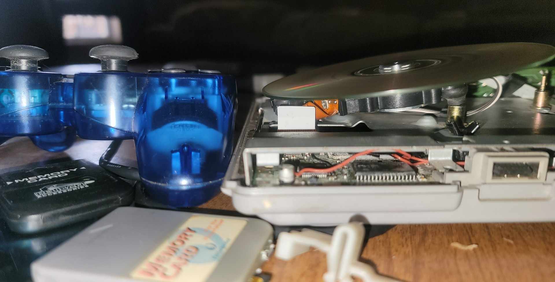

yeah i figfured it out, deff something up with the mayumi v4 files i got for the 12f629. i tried mm3 for it on the TL866ii plus, same chip i wrote mayumi v4 to, and got it first go. that said after reassembly today game or no game i am stuck on the white sony screen... could be a fuse apparently, gonna check that and my wiring later today. i really like that the tl866ii plus automatically seems to leave the oscal alone and doesn't let it get over written.
Edit: it isn't a fuse gonna have to ohm it out with a multimeter. So for now i have a scph 9001 without a cd drive, frankenstation anyone?
Yeah...
Edit 2: a little less franken station.

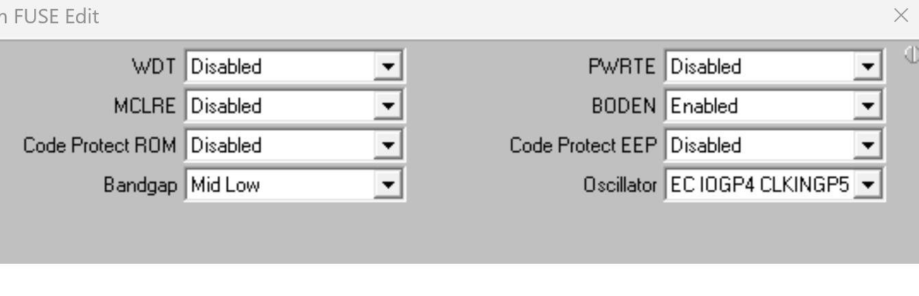

You can't make a PIC18/16F device read only/write protected - the CP and CPD configuration bits exist to prevent you from reading program and/or data (EEPROM) memory back via external tools.
This excludes 'modern' chips with the ability to write their own program memory - those often have a set of configuration bits to prevent firmware from accidentally overwriting segments of its own program.
I'm not 100% sure about this configuration bit (attached)
Try setting it to something that looks like this :
100 = INTOSC oscillator: I/O function on GP4/OSC2/CLKOUT pin, I/O function on GP5/OSC1/CLKIN
