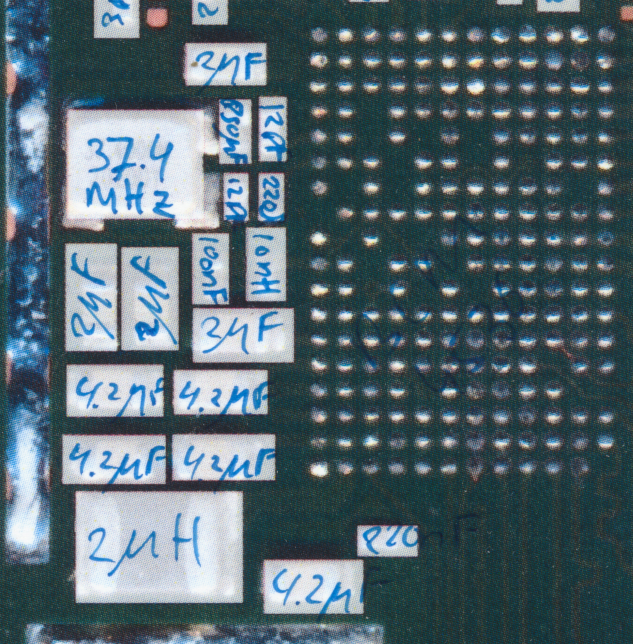

Hey there,
I'm replacing the wifi module chip on the switch oled motherboard, and in the process, I had 2 capacities who got away... (circled in blue on the photo)
I wonder what's their reference that way I can replace them,
Thanks for your help,
Cheers
A quick test on a board I have laying around, the cap on the left measured 5.2k ohm and the cap on the right fluctuated between 1.0 and 0.9 ohm.
