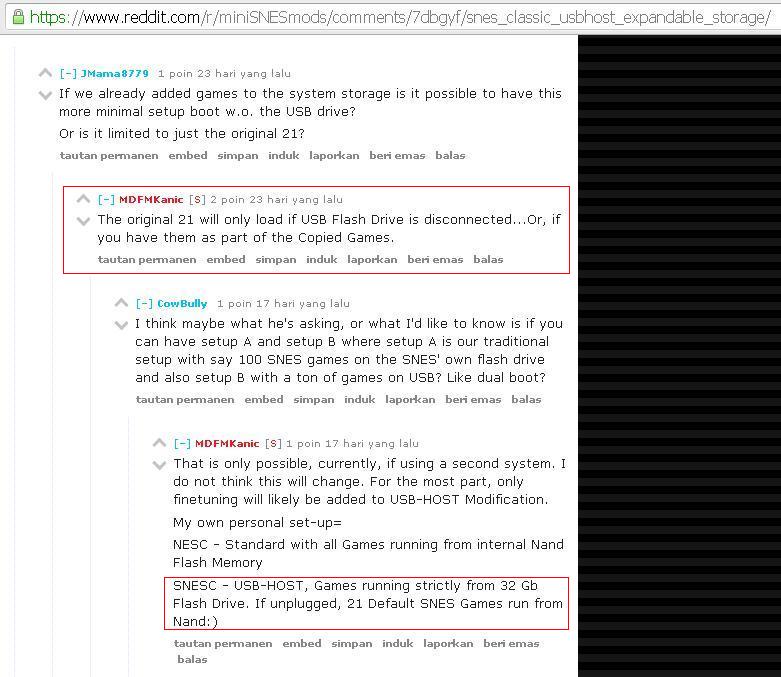

@KMFDManic , I just read your comment on Reddit (please see attachment) and found out the reason why I can’t get my original games running (got C7 error all the time). Let me clarify these:
1. If I had already unlocked Star Fox 2 (original game), does that mean that I will still have it unlocked when I remove the OTG hub? Because if I’m using USB Host, my Star Fox 2 is still locked and my previous saves are gone.
2. Based on your statement, does that mean I have to add the 21 roms (of the original games) if I want to play them with USB Host?
Many thanks!
Many thanks!
My 21 games work just fine.
Many thanks!
You running with a /saves folder on USB-HOST?
