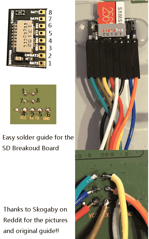

I'm SO ordering that SD breakout board!
I made a quick guide for soldering the breakout board following Skogaby's tutorial on Reddit.
As I'm just diving in the extended memory mods, when the guide says to add games to X folders, do I put in the rom or the folders which hakchi turns the rom into? (those "CLV-H-AKBHR" folders) Thanks!
Oh and after all this is installed and I want to add games, I use the hakchi2 supplied in the guide right? Skogaby's mod? For more info, where are the saves stored so I can back everything up to the SD card?
Join the discord chat and talk to skogaby himself. :)

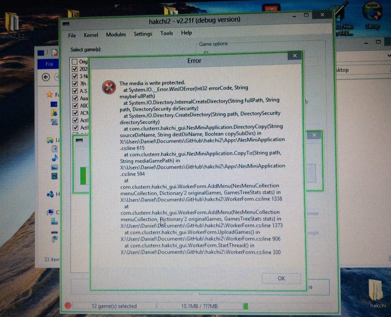

Been following this thread for ages thanks for all the guides ect Iv had my snes mini running perfect since it was hackable
But since doing the USB mod (which works fine btw) if had a right headache actually any game to run
First off if I copy my predone games to the USB drive it sees the games on there but I get a C3 errror then a c7 when trying to run anything (I thought u could just copy your games folder from previous hakchi and it would work)
I have 30 games on there as. Test
The second real pain is after adding games to Danthemans hakchi then holding shift and hitting synchronise choosing the USB drive I get the media is write protected every single time
Iv tried 6 different USB drives and microsd cards as well nothing will work
If I choose a folder on the hd to save to it goes through the process but the folder is empty it's all weird
it's got me beat tbh it simply won't create the games or says folder isn't empty, I take files out but then it errors lol
It's not something simple that I'm missing is it?.
