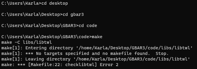

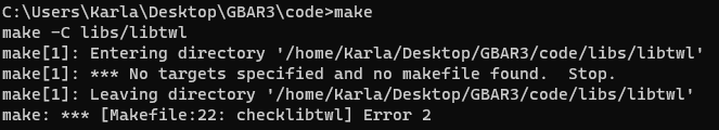

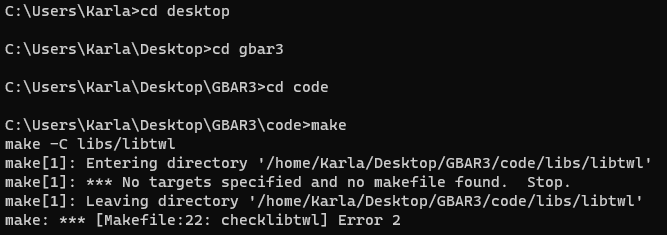

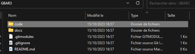

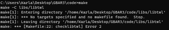

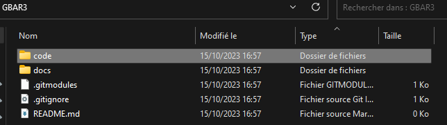

when I run the "Make" command I get this error message, I've probably missed something but I'm too new to this type of exercise to know what it is exactly.
I have downloaded and installed the latest version of devkitarm/libnds as well as the latest version of python and visual studio code (just in case, the latter two may not be necessary)
here is what I got from Github :
and this is what I get when I run the "make" command from the Code directory:
Also, the version I'm currently using of GBAR2 that works on my flashcard is a version named arm7dldi_ds, so I assume to get the same result with GBAR3, I need to compile an ARM7 version, correct?

Yo need to run the "make" command inside the `code` folder

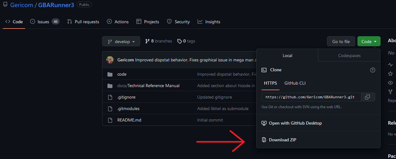

I think you didn't clone with submodules
git clone --recurse-submodules
I think that's what I did but maybe I was wrong, I don't know here are the commands I typed to look for the "make" in Code folder :
Here's what I did and what I uploaded to Github :
I'm sorry guys for making such beginner mistakes but this is really all new to me both compiling a file but also using Github:blush:
Thank you for taking the time to help me, it's really nice
No worries haha, it would be ideal to clone recursively like Gericom said, by tipping this on the CMD:
Because your files have libtwl module missing. A "manual" way to do this is by downloading and adding this inside
code\libs\libtwl

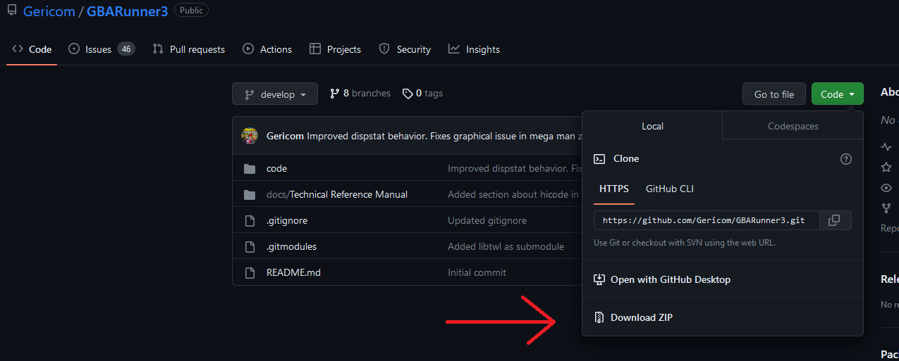

Downloading the zip won't work. Here's some instructions I wrote up previously.
The gist of it is to install DevkitPro w/ NDS presets (other settings optional), clone the GBARunner3 repo with modules (git clone --recurse-submodules https://github.com/Gericom/GBARunner3.git), then run the MSys2 included with DevkitPro, navigate to your GBARunner3 repo inside of MSys2, and run make in the code directory there.
You should run the "git clone" command inside of your Command Prompt or Terminal.

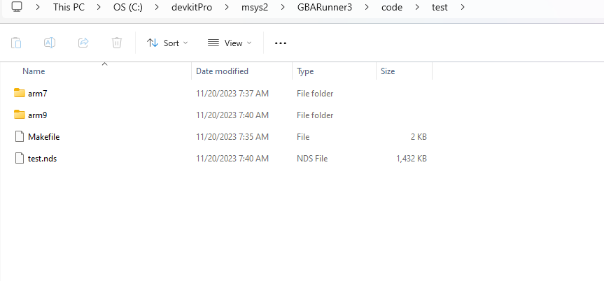

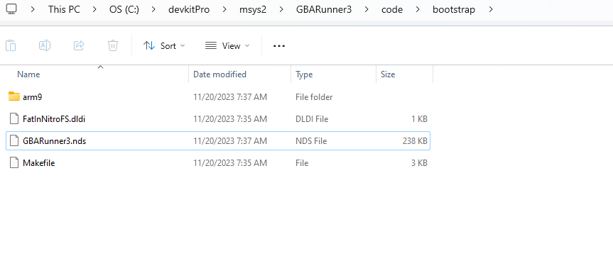

thanks again for all your advice guys, I think I made progress, I got two .nds files, one called bootstrap.nds which I renamed GBARunner3 and one called TEST.nds, I tried both but I think I figured out that only the bootstrap.nds file was needed, so I applied two methods to try it.
the first by following Gericom's instructions for TWL++ (for information I installed the latest version on my R4), I put the bios in the _gba directory, the emulator with the other emulators and I modified the file TWL++ settings
For the second method, I put the bootstrap.nds file (GBAR3), the bios and a game in the same directory.
For both launch methods, when I try to launch a game, only the bios seems to launch
Using TWL++, I use the same directories that I used with GBAR2, that is to say a directory at the root containing subdirectories where my games are stored
I also tried to launch a game from a gba directory placed in roms\gba but I always get the same result, only the bios seems to launch and I get stuck on the GAME BOY logo
Are you using a flashcard or a DSi SD card? And yeah, the correct build is "bootstrap.nds", you just need to rename it to "GBARunner3.nds", the "test" binaries are only meant for development purposes.
I'll write the instructions again just in case:
To have GBARunner3 test builds loading GBA roms in TwilightMenu++ you need:
-TwilightMenu++ 26.1.1 or higher
-GBARunner3.nds inside \_nds\TWiLightMenu\emulators
-GBA bios bios.bin inside \_gba
-GBARUNNER3_TEST = 1 under the [SRLOADER] section in \_nds\TWiLightMenu\settings.ini
Reactions: Indy13

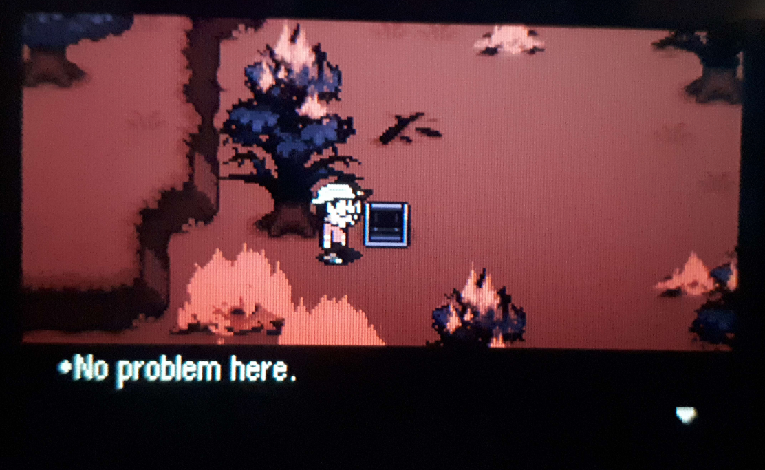

Well, just passing by to share the great news.
Mother 3 has been finally fixed and runs on GBARunner3
You can build the latest develop commit to try it out and report your testing results in the compatibility list.
Note: There are still minor sound issues that might get fixed eventually, keep in mind that this is still in initial development stages.
https://github.com/Gericom/GBARunner3/commit/356ee568fedb3e56e54bb7a09f7befbb4eb8ff95

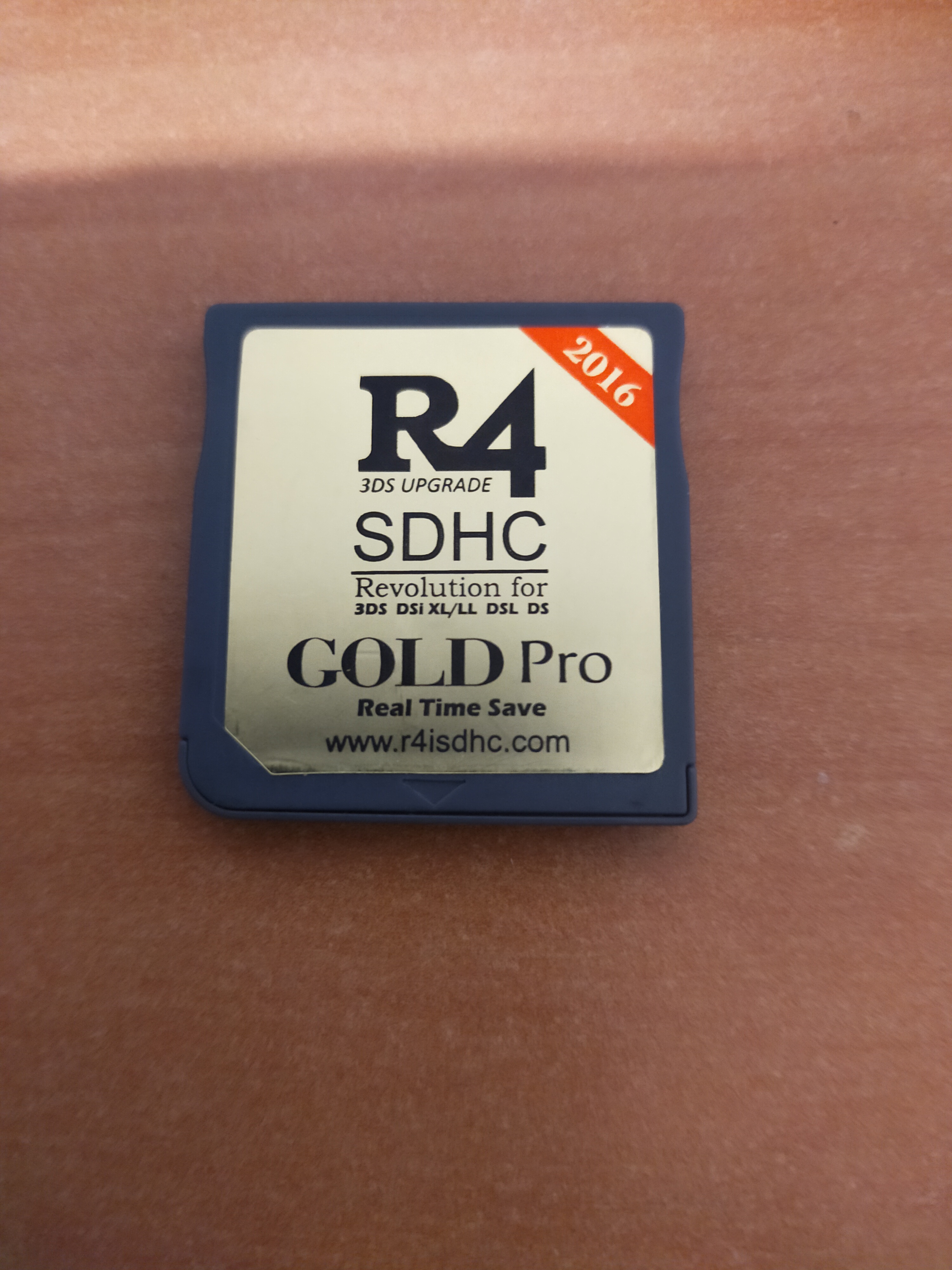

My GBARunner3 is finally working, sadly the pokemon emerald only shows white screen.
This is my card, running YSmenu.
