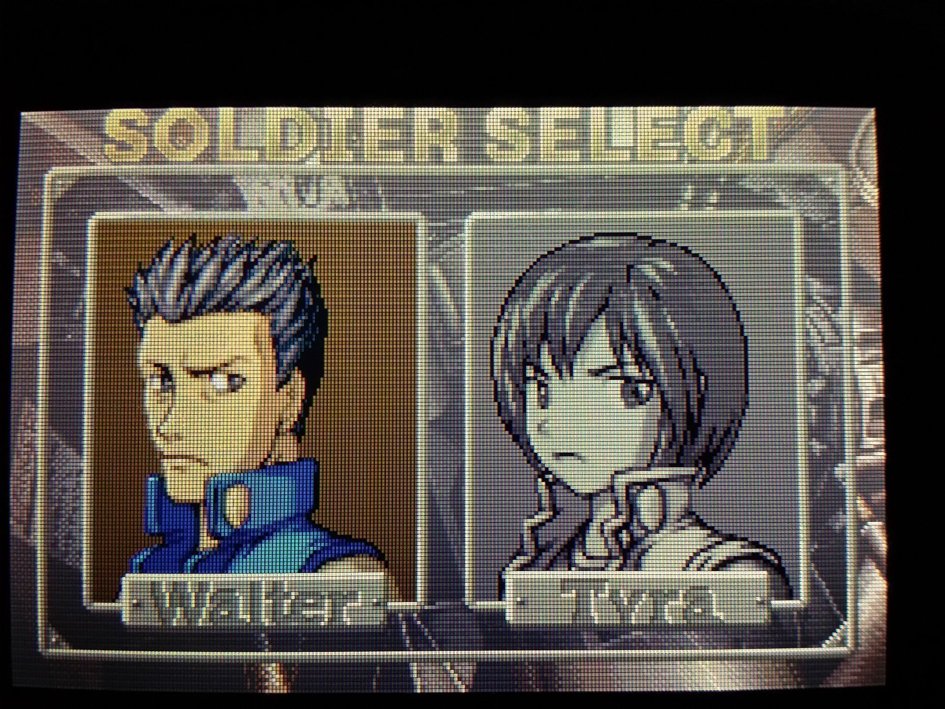

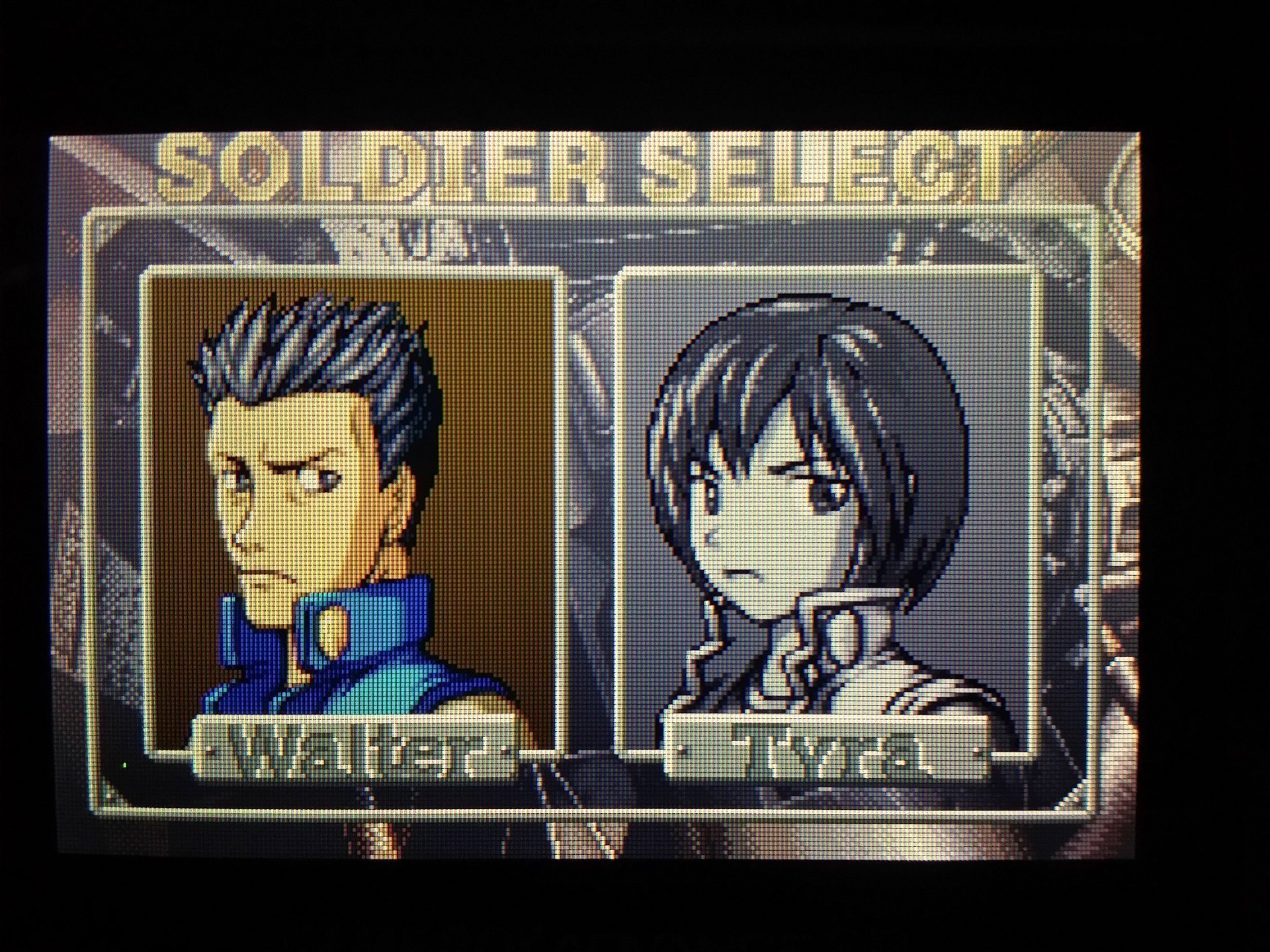

OK here are pics of each. The modded GBA is on the left, and the SP is on the right. Notice that the modded one does not have uniform color. It's hard to see the difference in these pics to be honest...
