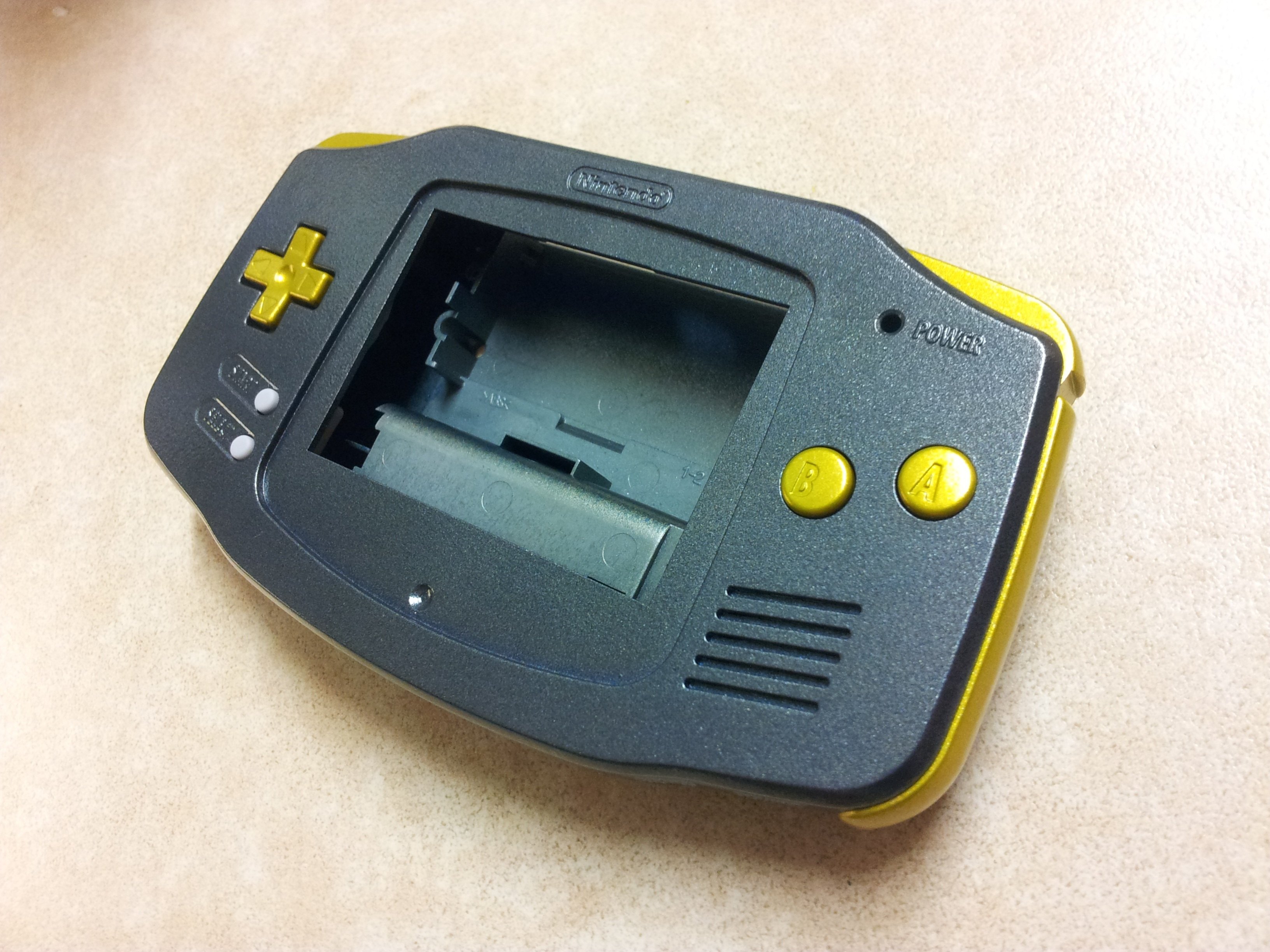

well everything went fine (except I broke the volume slider on the 001 mobo but that doesnt matter)
blacked out all the buttons since the graphite version came with black buttons instead of grey since the color of the unit its self isnt black but more greyish
the L trigger button doesnt seem to work too good, it doesnt respond most of the time,
took it apart, pulled the rubber stopper out and blew into the button, which sort of got it working again (it didnt work at all in the first place)

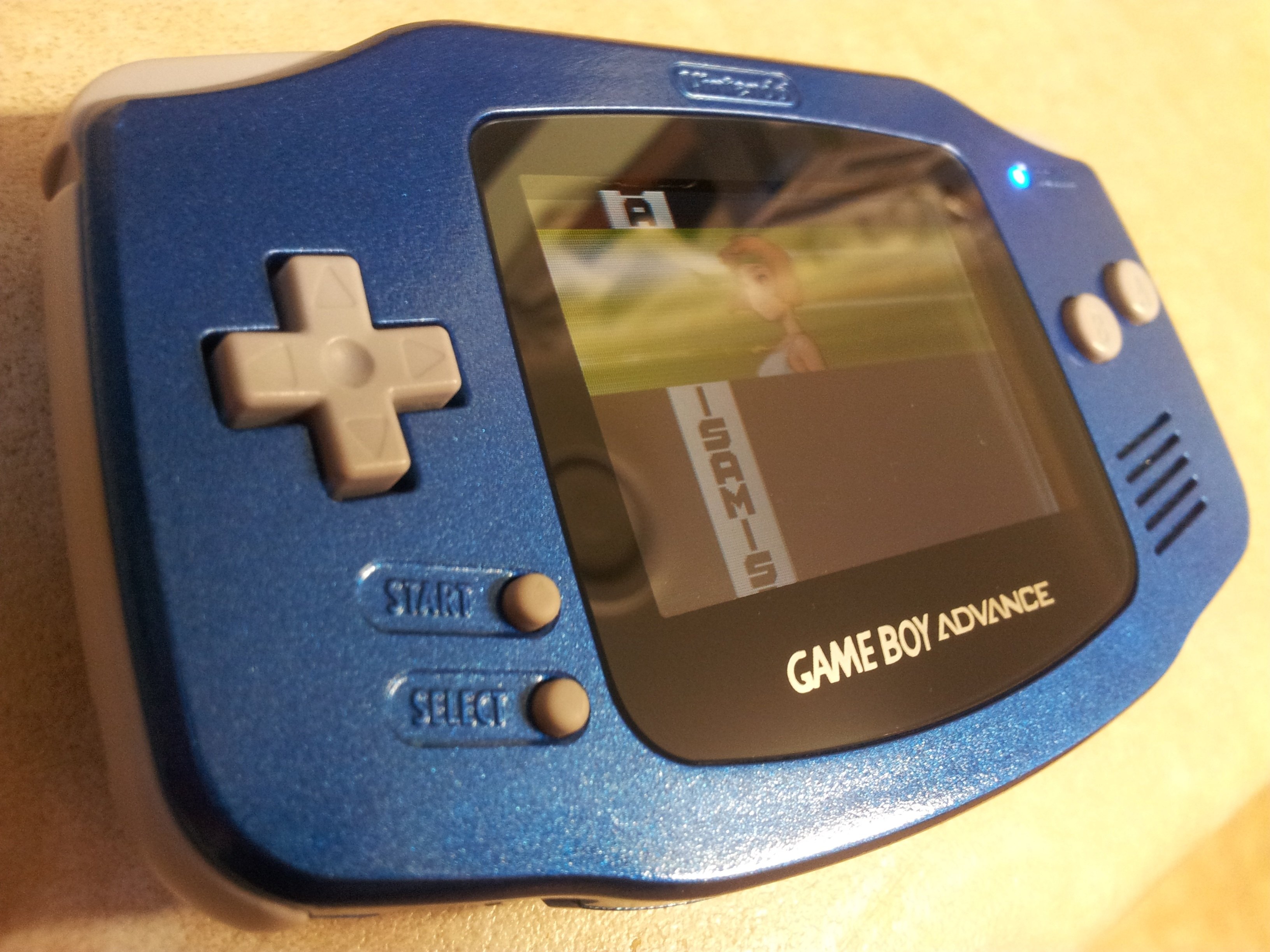

Wiggy, your work has inspired me to start painting again and here are a couple of examples of what I have created so far.
Thanks for keeping GBA alive and kicking! =D

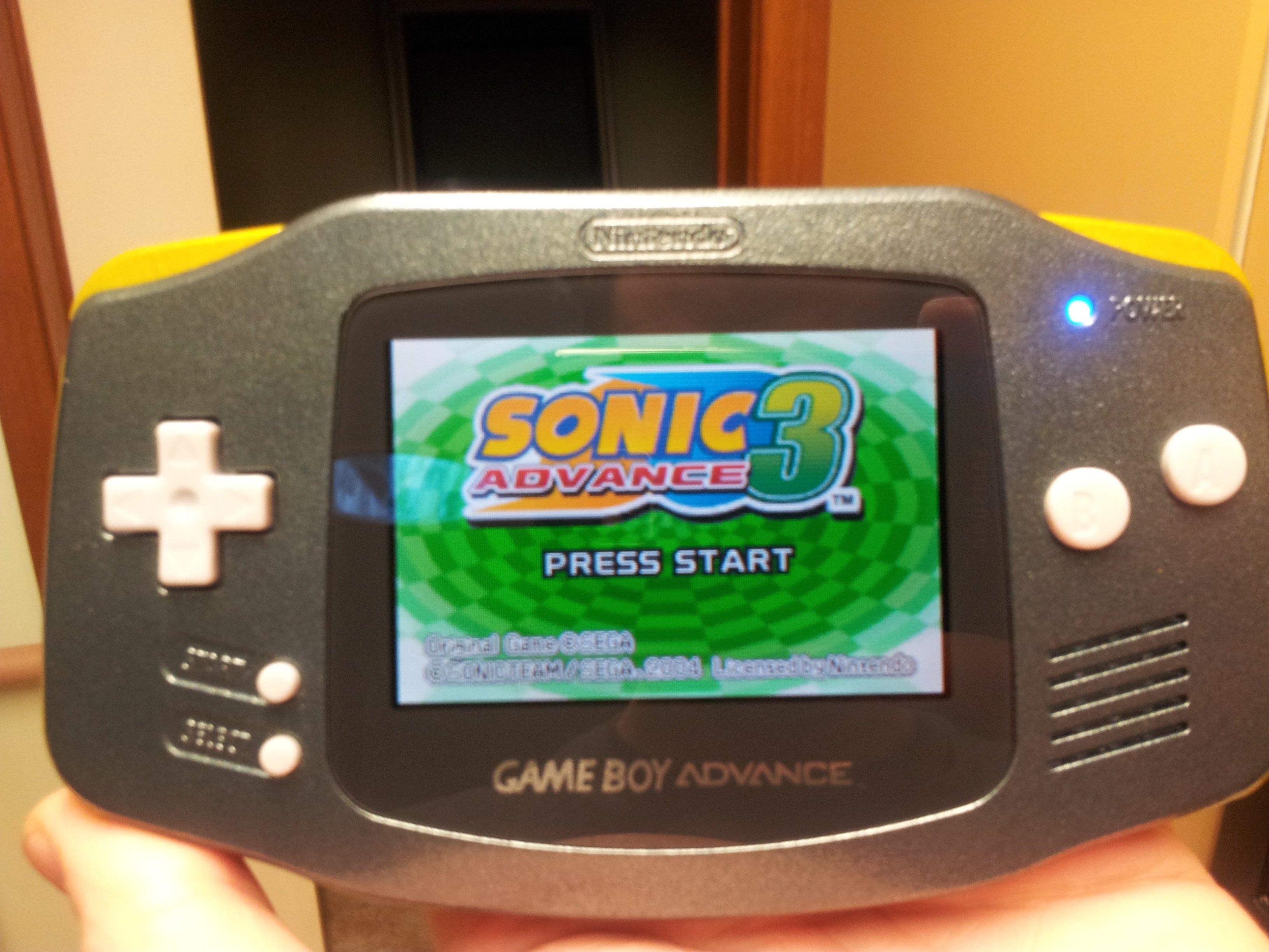

Just wanted to report I ended up being another happy Zerey Zhang customer
(low light picture taken using the HDR option on the iphone)
backlit translucent light red (pinkish) GBA + frontlit atomic purple GBC + EMS shipping to Europe = 136$ (in January)
nice guy
