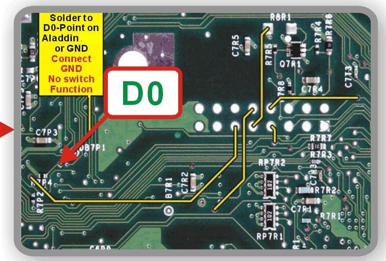

Hello.:)
Maybe an Alternative for you:
You can get an Aladdin Chip from Amazon or Aliexpress (they are all the same):
https://www.amazon.de/Sairis-Professionelle-Hochtechnologie-Verwendung-Original-Mod-Chip/dp/B07ML3Q2XB/ref=sr_1_23?__mk_de_DE=ÅMÅŽÕÑ&keywords=xbox+aladdin&qid=1573838287&sr=8-23
It cames with an BIOS for the 1.6 XBox.
The 1.6 needs the LCP Fix - 6 Wire install/soldering work,not to diffcult (I did it, so it can not be that hard...:D ).
(Bottom Side of the Mainboard)
The Aladdin XT Mod Chip needs a little Modification too - XBox LIVE Function is no longer needed:
Maybe an Alternative for you.:)
