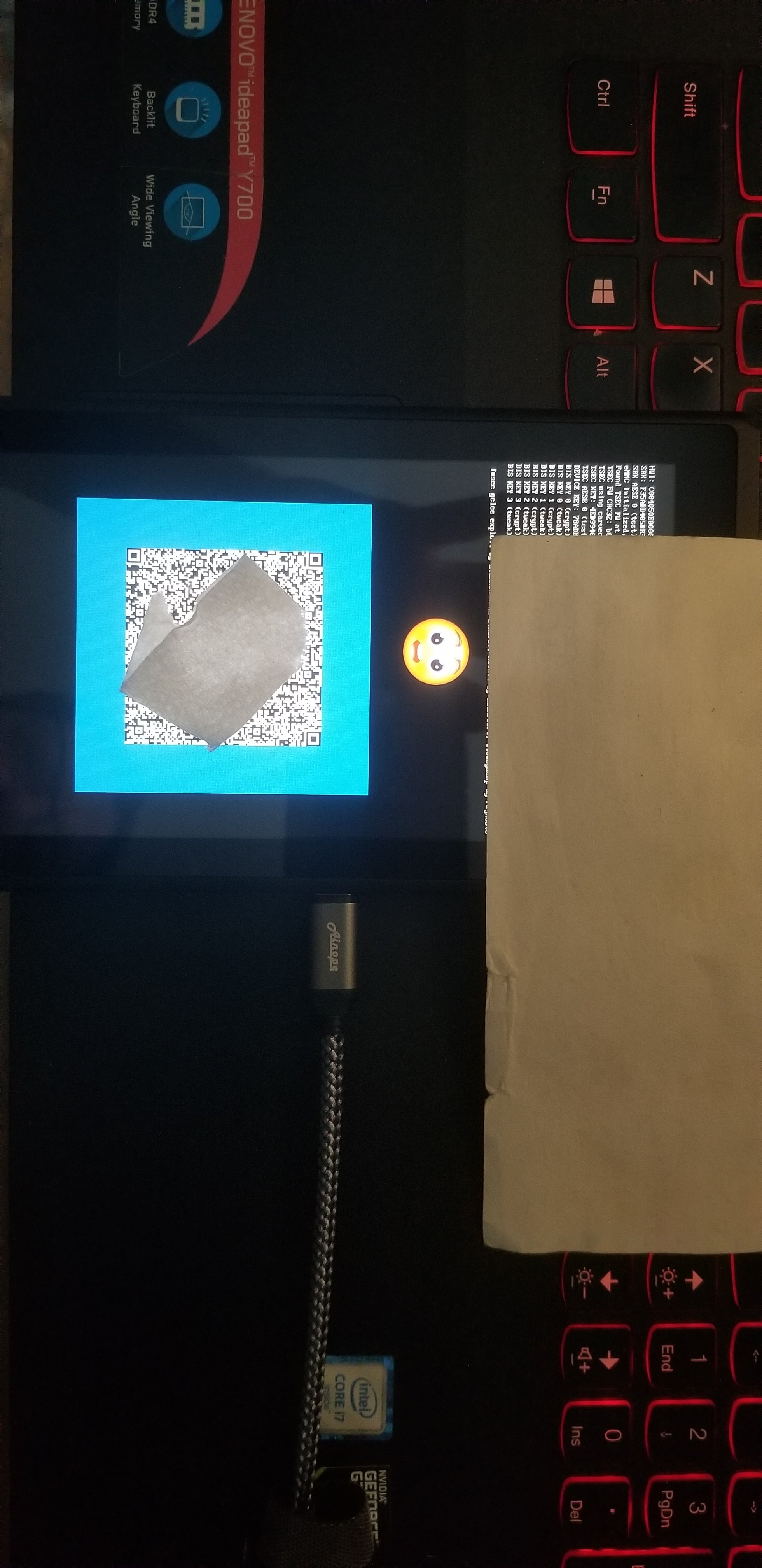

Well! After my girlfriend going to 4 different stores and having the sales people and store manager check every S/N of at least 15 to 20 Switches in stock per store because they have them locked up! :D She finally was able to find one that was on the good S/N list. The crazy part is that it was the last one in stock that had a good S/N.:yayswitch:
The minute I ran TegraRcmSmash1213 and biskeydump payload! The screen on the Switch came on right away displaying the keys, where the first one I had didn't...
This things are getting harder and harder to find. I got lucky that my girlfriend was able to find one for me...
Serial: XAW100801xxxxx
Serial on device matches serial on box: yes
Region: US
Firmware: 4.1.0
Color option: Gray/Black
Store: Target
Was a bundle (if yes, which): No
Purchase date: 7-14-2018
Fusée Gelée works: Didn't try it with Fusée Gelée! But Yes! It worked with (TegraRcmSmash1213 and biskeydump payload)
I'll be posting this info to the other link... ;)
