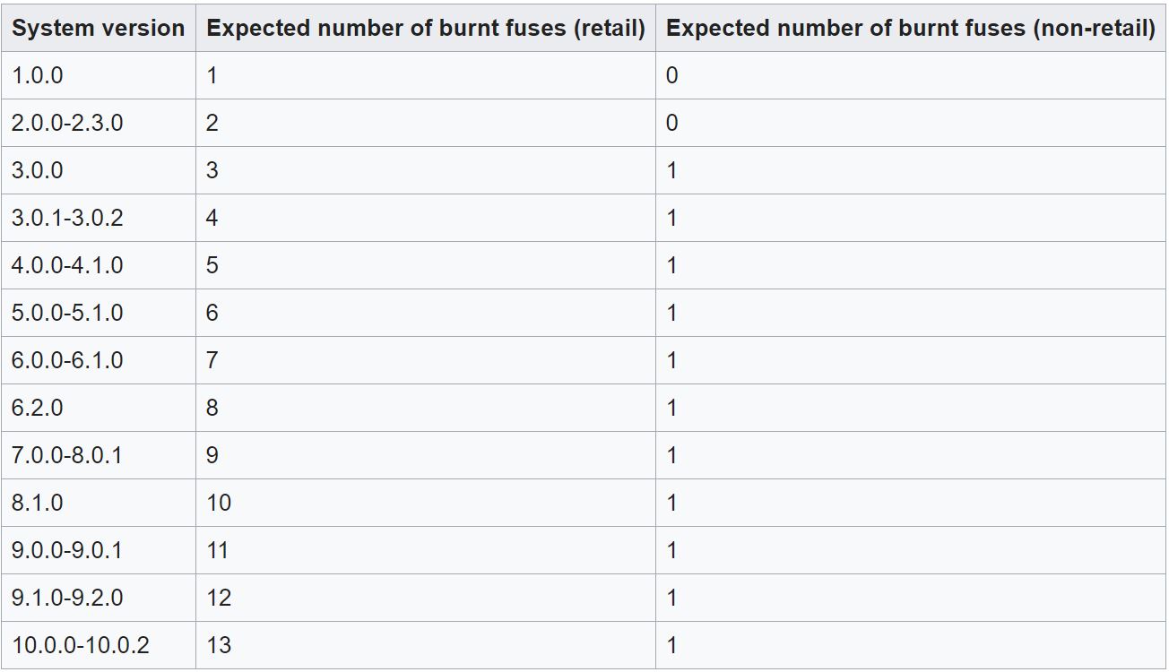

To apply a system update which should work, I would recommend using system version 5.1.0.
As choidujour.exe has issue with above 5.1.0 sometimes and 5.1.0 never fails.
Then after you followed the guide and using FS.kip in hekate to boot first time. <A must.
Using cfw to be able to use ChoidujourNX to update to the system version that matches your fuse count. >
Apart from following the guides and applying a manual system update, Or trying to wipe user partition there is not much i can suggest.
