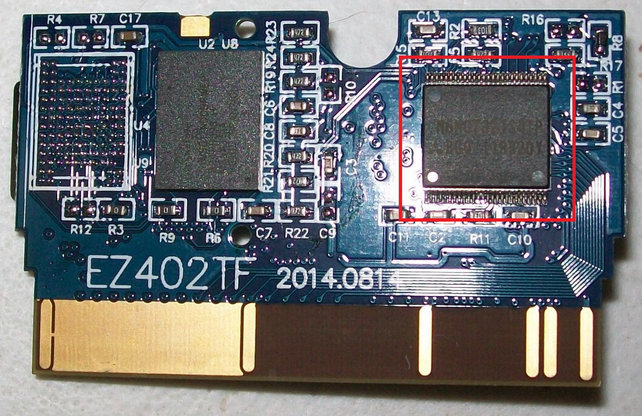

Hello,
hope somebody can help me
I have the EZ flash IV white version, the mini sd one.
I tried all the updates from the official website, and all I got is a blue "EZPDA" screen, and then, a lot of black lines starts to fill the screen.(look at the picture)
the mini sd is FAT16. I tried also to format it to fat32 AFTER the update.
However, when I use a 1,71 firmaware (or below) I can use the cart with no issues.
Does the white cart support the latest firmwares? If yes, What I'm doing wrong?
I had the same problem, I solved by remaking the solders of this IC.

well, its an older bump. I assume it's more likely a non-compatible sd card anyway.

I would rather just buy an EZ-FLASH Omega than put a soldering iron to that board. I also don't have the right soldering iron tips to do such a 'repair'.
Here we use to fix things, not put in trash and buy a new one. This flash card have a bad soldering work. I'm using a 2gb micro sd, working perfect on fw 2.05.
