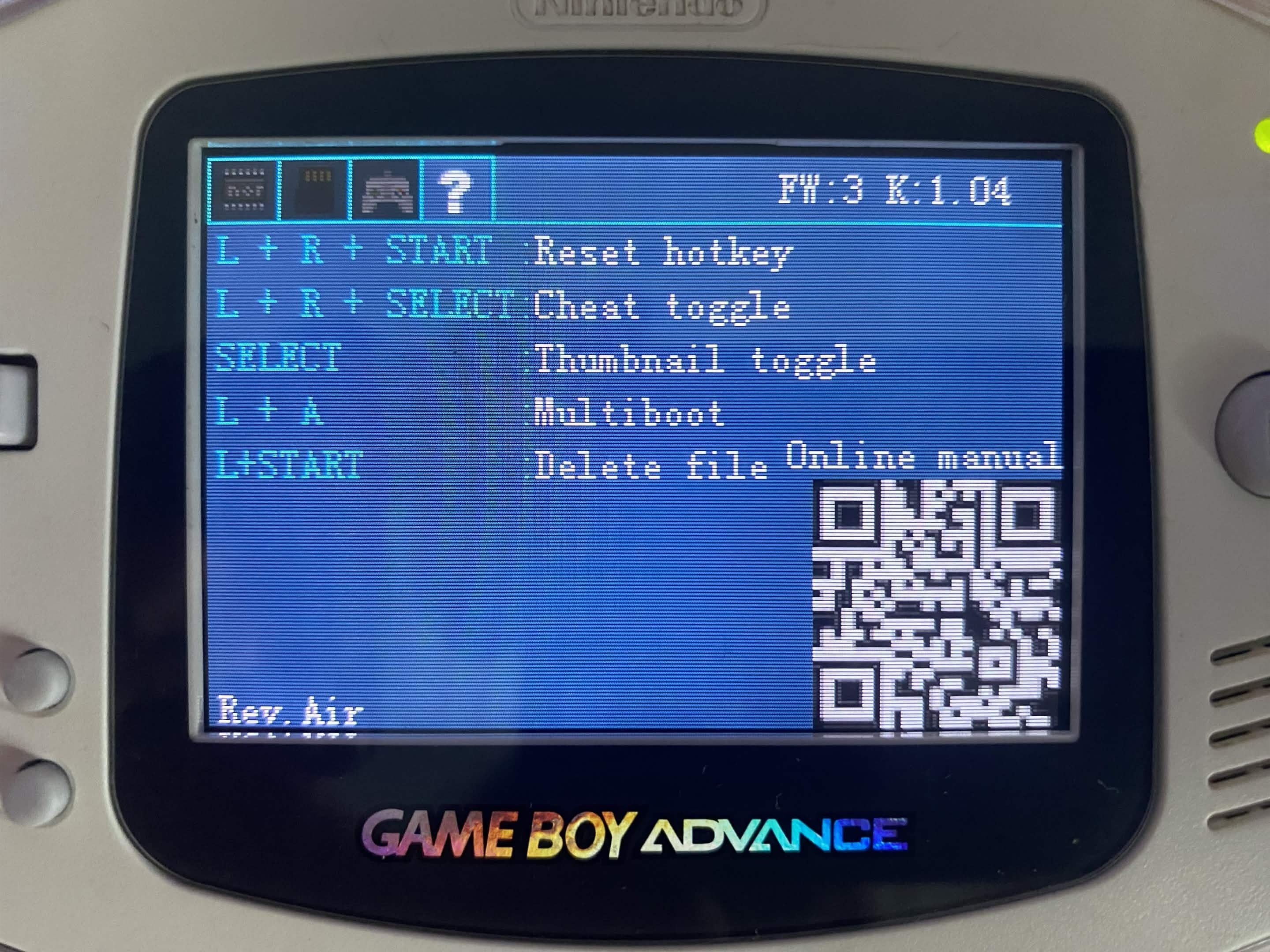

Two days ago I've recieved my EZ flash Air that is also my first flash cartridge for my GBA. Most of GBA roms don't work at all or glitch and even crash which was unexpected.
Included 64 GB SD card did not detect half the times booting and corrupted GBA roms after transfer. GB and GBC roms seem to work flawlesly.
In desperation I decided to buy 32 GB Samsung SD card. This one, while detecting every boot, also corrupts GBA games. The wierd thing is that it stopped displaying all files only showing 2-3 first positions.
I have also tried it with generic 2 GB SD card but it has also been unsucessfull.
I have formatted all of the SD cards according to the manual and updated the kernel to newest version.
All 3 cards work perfectly on PC reading and writing files.
Is there any fix for these issues or should i consider returning AIR.
On the picture the most glitching (but also not crashing on startup) game GT Advance 3.

Did you update the firmware? Make sure that the number in the menu matches the one on the website
Ye i have tried updating it several times,
Sekno support offered sending me another one if i send this one back and they will cover the shipping costs so if new works it will be all good.
