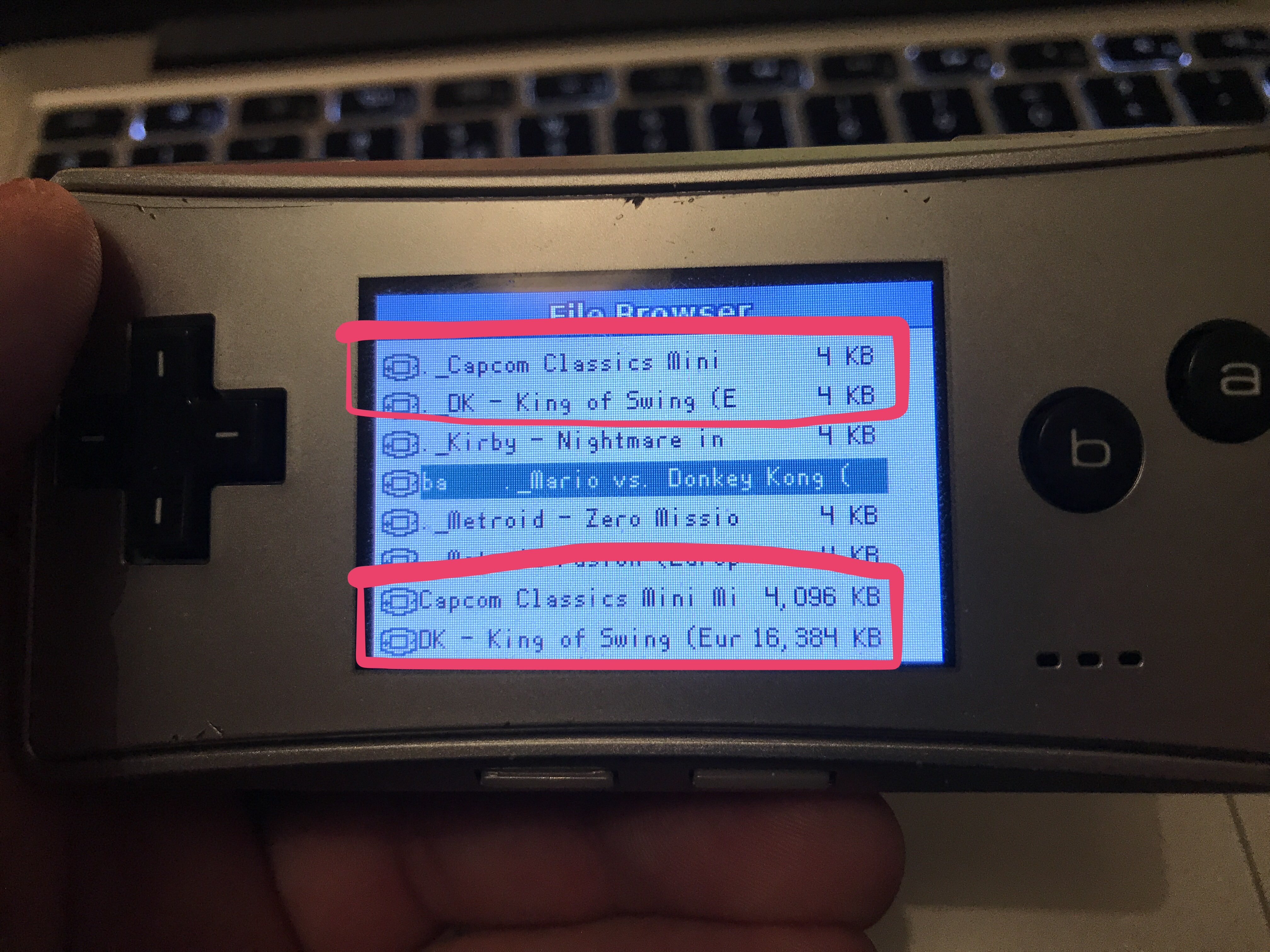

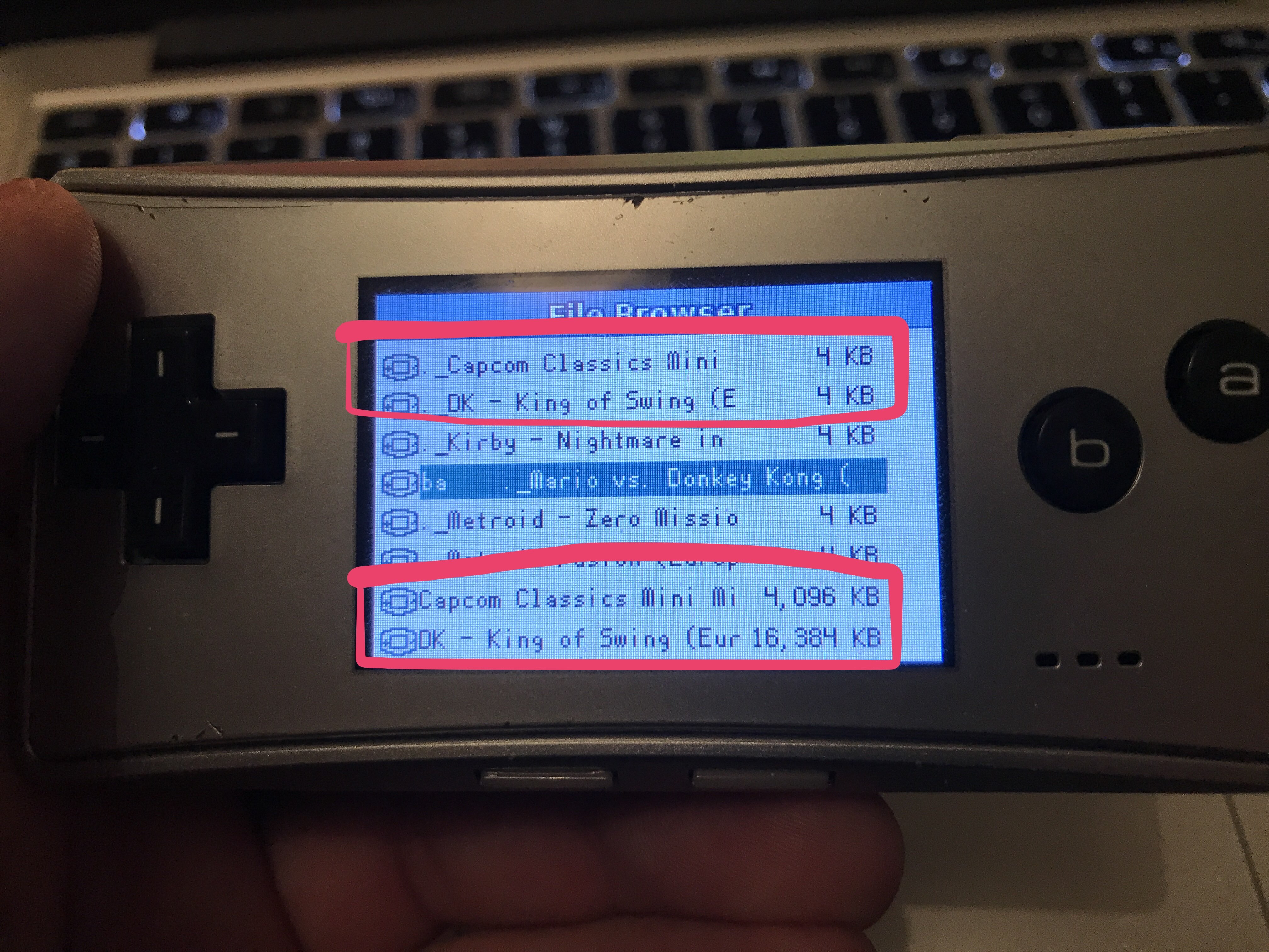

In my ez-flash IV with 2.03 kernel I have double roms of all games
FIrst rom have about 4kB and I can't open it, 2nd rom have normal size and I can open it (picture below)
But it is little frustrating because the list of games is really long.
Anyone have the same problem?
Are you using a Mac?
Well, then that's the issue :)
Mac OS's finder creates Metadata files with underscores. I know there is some way to stop that but I don't know because I am not using Mac OS. You're going to need to search for that.
Thanks for help:)
Now I use BlueHarvest app and no any more problems with metadata on Mac OS
Maybe it is good advice for other Mac users;)
"Same" problem is in Windows too: Windows likes to create hidden System Volume Information, which will also show in when using EzFlash.
