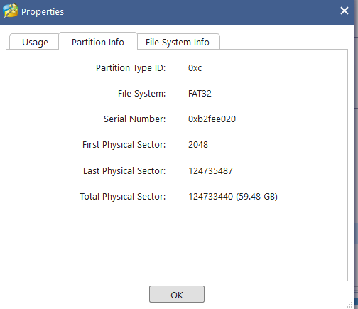

I read that you can get SD cards larger than 32gb to work by formatting them with guiformat to FAT32. I have my DSi modded to boot into TwilightMenu but it just won't detect my SD card. Works fine if I use a 8GB microsd with an adapter. Am I missing something? Here is the exact card I'm using:

Sometimes cards have extra partition data that won't be cleared by guiformat. You can use godmode9 or Minitool Partition Wizard.

I think I tried minitool and it was still being a pain. Might just be picky about this particular card.

Because those over 32 GB cannot be standards-compliant SDXCs, which by definition must have a single FAT64 (aka EXFAT) MBR type 7 partition, while a SDHC has a single FAT32, MBR type C one - no significant low level differences unlike with SDSC
