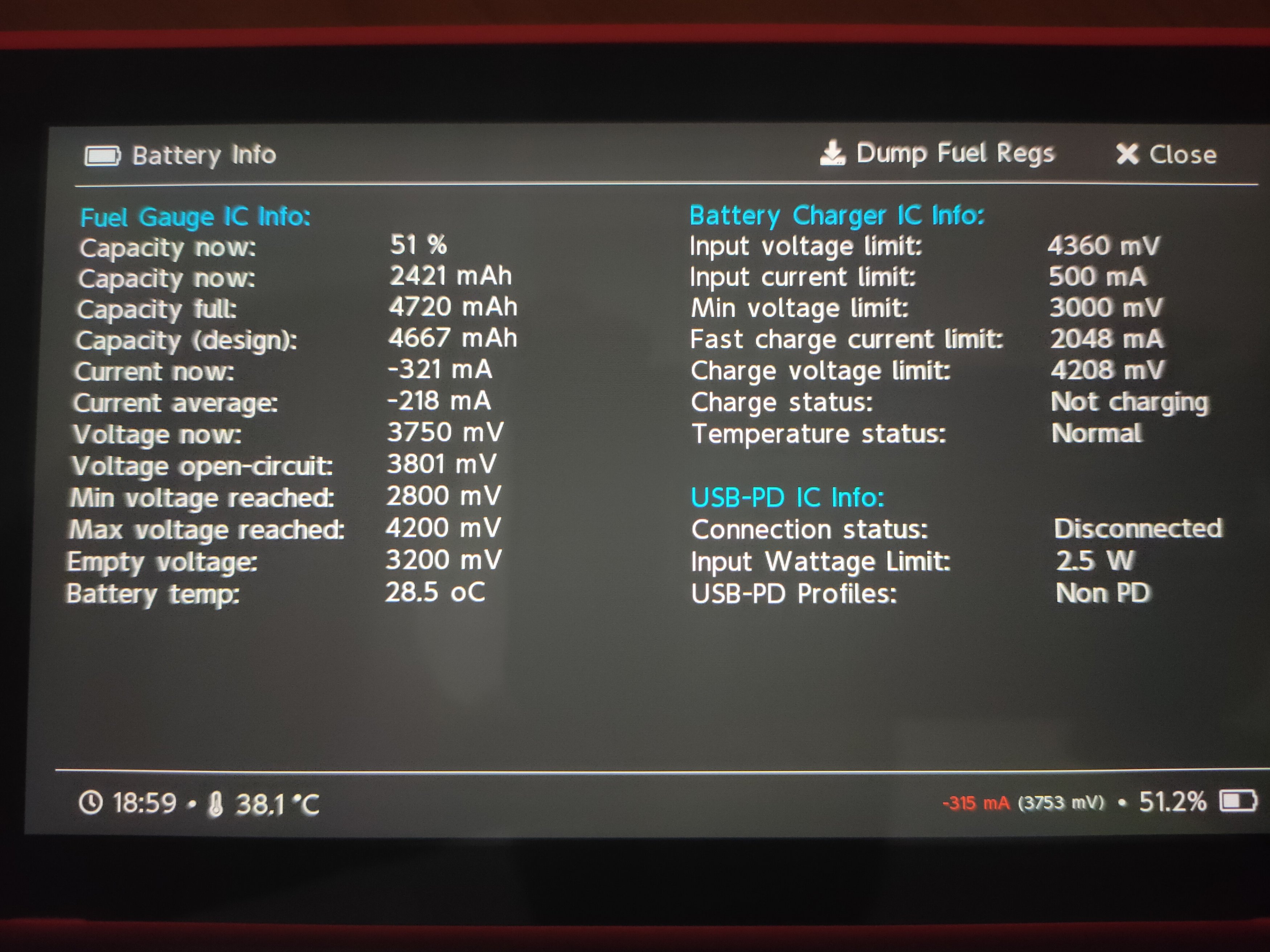

I made a picture of my battery info screen so that all the info's there in one go. The only thing that sticks out here to me is that the design capacity is lower than the full capacity (not sure if that's important, though), but beyond that I'm not sure what to make of these numbers.

Err, for some reason I managed to miss this version of this post. I can't tell if the soldering is at fault here. I didn't do the mod myself and I don't really want to open the thing up right now for various reasons. The main question on my mind would be if the battery desync I've got is just an inconvenience or if it's a serious problem (as in, shortens the battery's lifespan).

capacity full is nearly 200% of design.
this correlates to me seeing the switch shutting down around 50%
i get a good 3 hrs or more out of it but would like to know if i can get a correct % reading
thanks!
Mine shows ~150% of design capacity, and predictably shuts down when it gets to the neighbourhood of reading 25%. Did you find a solution?
