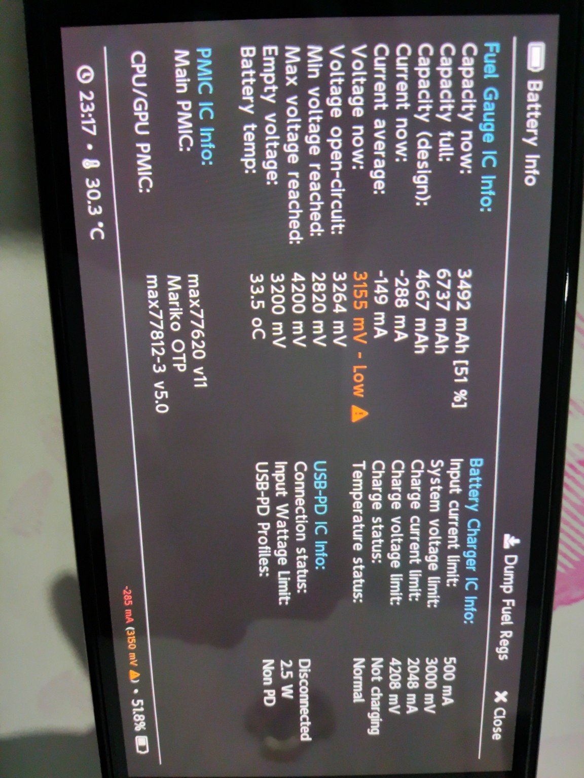

This is my last battery screenshot im at around 200+ cycle , for my case i think it take the % from the MaH . This screenshot is from the 2nd cycle (100 [battery desync X button used here] -0-100-0 ( this step )

Did you do 2 full charge cycles as mentions in the description?
Also note all the other conditions for making the calibration work :
https://github.com/CTCaer/battery_desync_fix_nx
