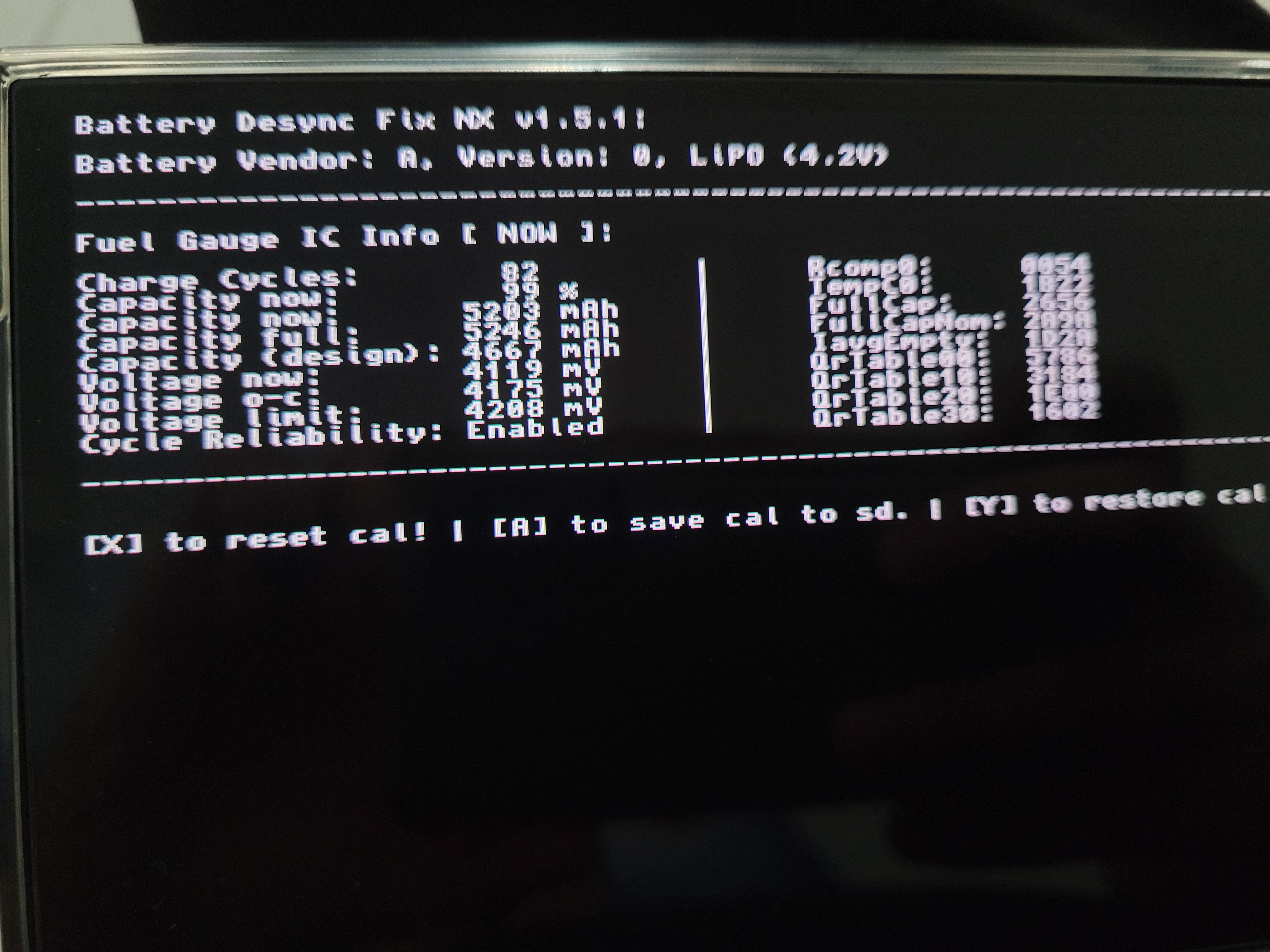

So, i'm having this problem since i pressed X on battery desync fix NX on Emummc, and ever since i did that, whenever i go to charge my battery capacity full keeps going up as time goes by. I thought it was normal then i let it charge until it stopped around 6400MAh while the design capacity is 4667MAh, after that i tried cycling the battery 2 times but to no avail, then i tried to open my OLED model and disconnect and connect the battery, a lot of stuff reset but not the original full capacity, so im kinda lost. do i need to keep repeating charge cycles until it normalizes? because with the way its going its always shutting off around 28%, and whenever i turn it back on it restores that previous context.

Yes, i'm trying to use it but everytime i try to reset the fuel gauge and do the 2 charge cycles the capacity full keeps going up, ive measured and the lowest voltage i could get before the switch turned off was 2800mV, and i've read it that the minimum should be 3200. my charge cycles still doesnt update in the app even tho i let it die multiple times and charged for more than 8 hours
