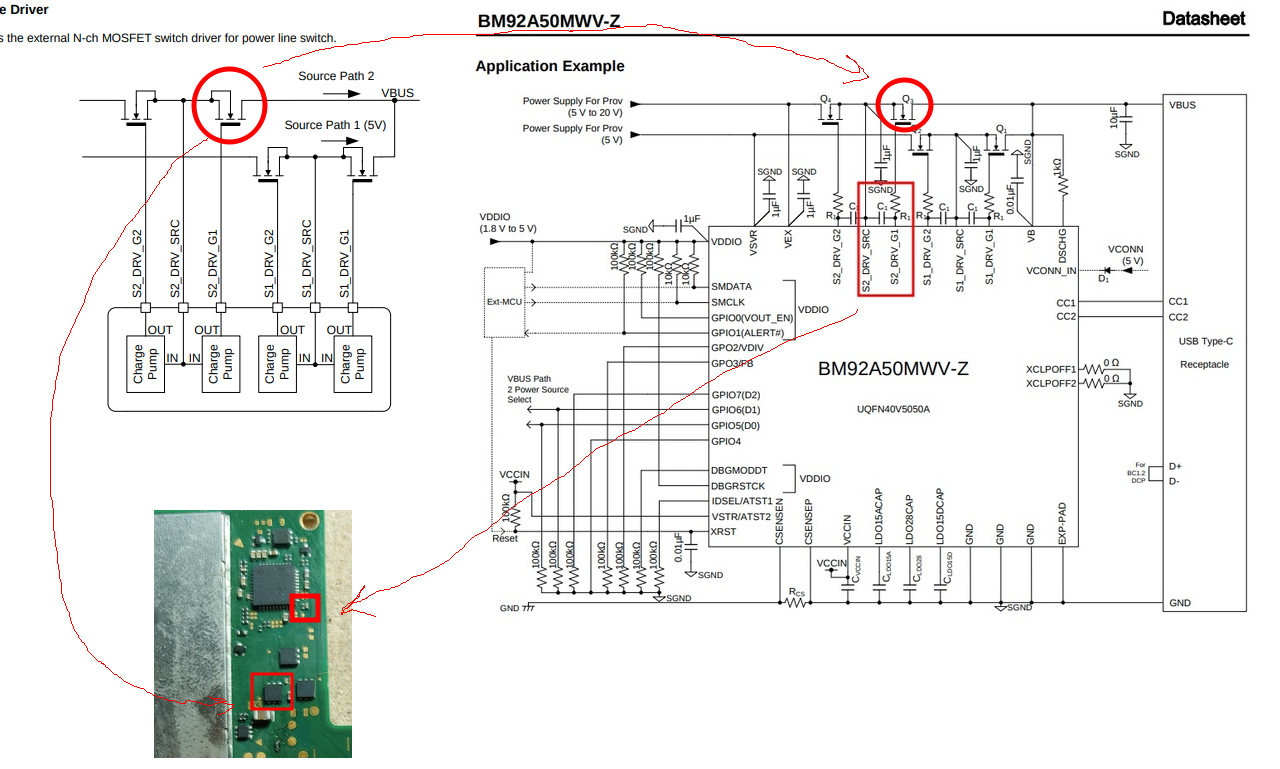

The red points all have continuity to Pin 22 on the M92 but this goes if I remove the little cap which is showing 0.12v in the diagram.
The yellow points are the 2 Via's which I'll try and trace next.
