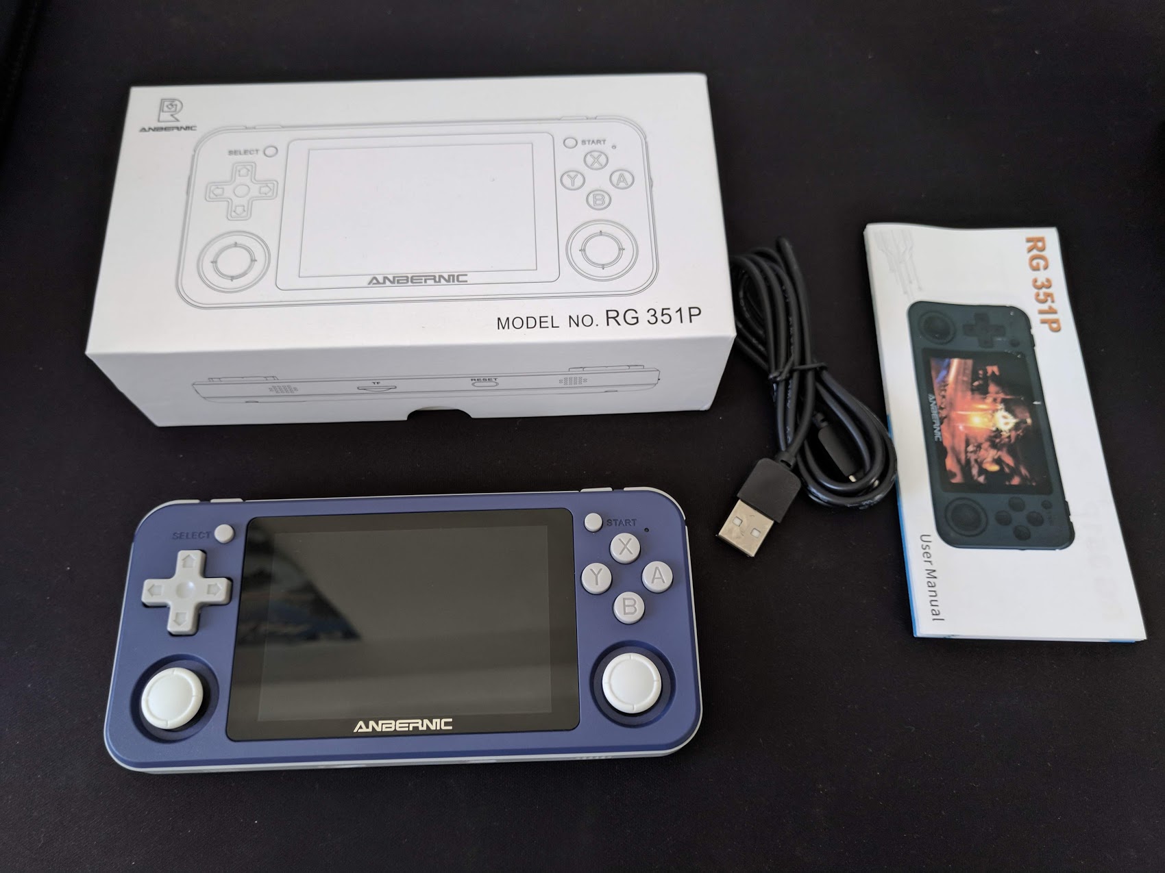

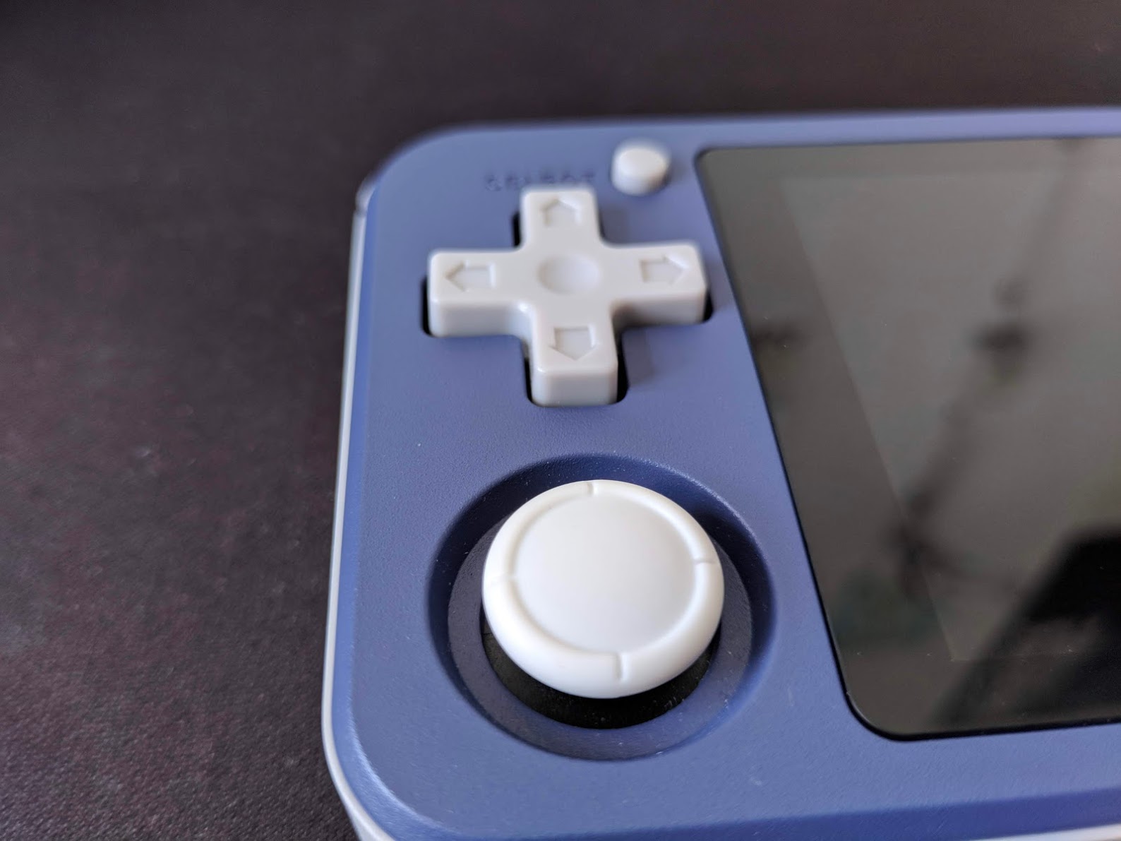

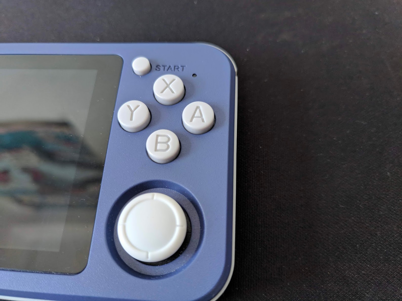

BittBoy’s RK2020 is also based on the RK3326 chip but has several hardware issues that can’t be overlooked as I pointed out in my review. In that aspect, the RG351P is far better as Anbernic yet again makes a strong impression on the hardware front. If you’ve tried Anbernic’s previous device, the RG350P, you’ll know what to expect: face buttons with a pleasant, soft feedback; rubber grips at the back for added comfort; clicky shoulder buttons; and clicky analog sticks. However, I found the latter’s color to be a bit offset as they are white (in the “GBA Blue” model I received) while the rest of the buttons (face, shoulder, power, reset) are grey-colored (as is the side bezel). I don’t mind it much but if you’re nitpicky about the color scheme, this could bother you.

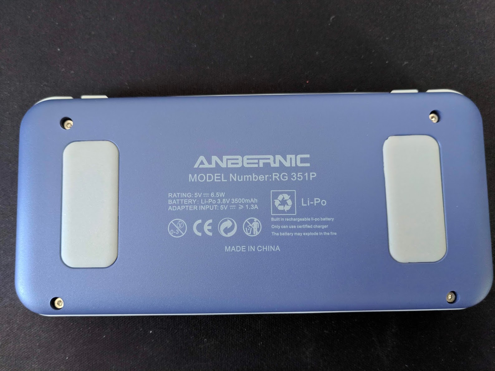

Another deviation from Anbernic is the removal of the HDMI port. While I use these handhelds only in handheld mode, others might still want to hook up the device to an HDMI monitor to game retro on a big screen but this is a missing feature from the RG351P. Moreover, the screws aren’t regular Philips ones but Torx screws whose screwdrivers aren’t as widely adopted. I found this to be rather counterintuitive for an open-source handheld device as it hinders easy access to the internals to, say, change the buttons or analog sticks.

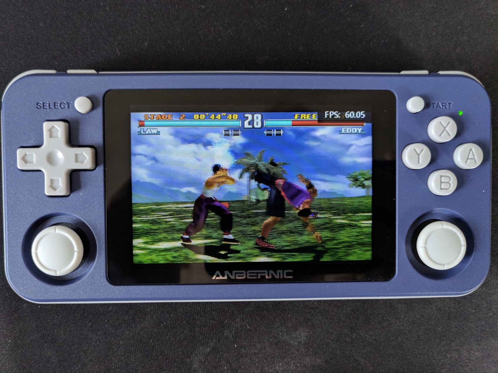

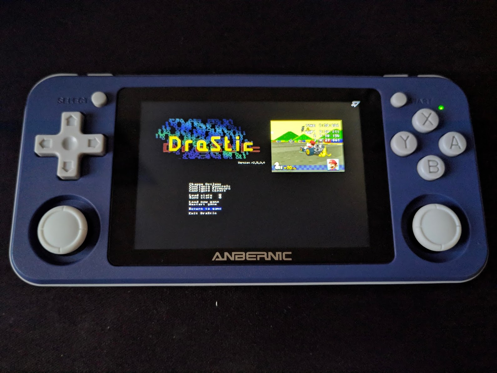

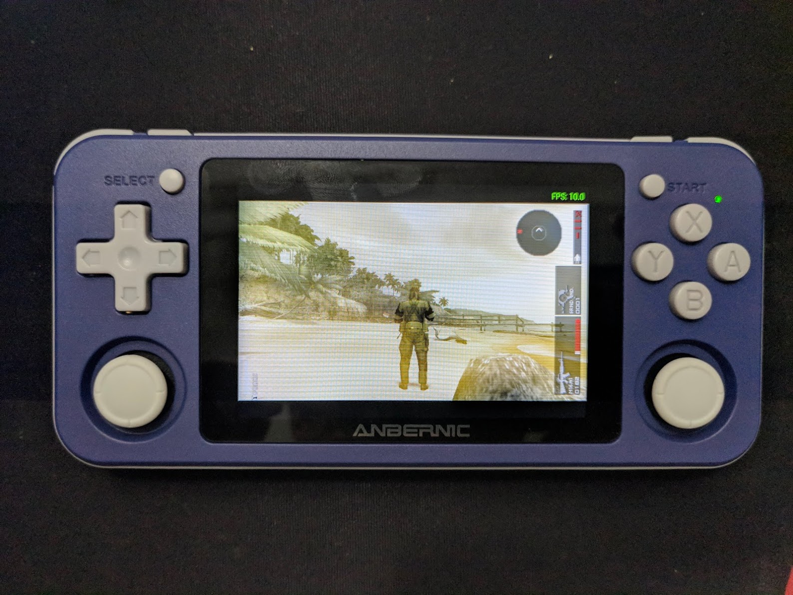

Nevertheless, the RG351P is still based on the RK3326 chip which is more of an incremental update on the previous “generation” of retro handhelds based on the JZ4770 (like the RG350P or New PocketGo V2). Officially, the device is said to support systems including the PSP but in practice, the best supported systems are PS1, N64 and most Dreamcast titles while graphically-demanding PSP games have a choppy performance. NDS games are also playable but the emulator has illegible fonts. What’s really good to play on the RG351P is GBA. This is thanks to its 480x320 resolution, which is 4 times that of the GBA (240x160).

NDS plays well but the emulator's menu has super tiny fonts that are almost unreadable. Older systems like SNES work well and as for Dreamcast, yes, games do play but with occasional performance issues depending on which game you play. You might be able to get better performance if you tweak the settings but there's quite a learning curve to that (it's based on RetroArch, so if you're familiar with it, you can try to work it out). For Dreamcast and PSP, it's not an out-of-the-box solution unfortunately.
