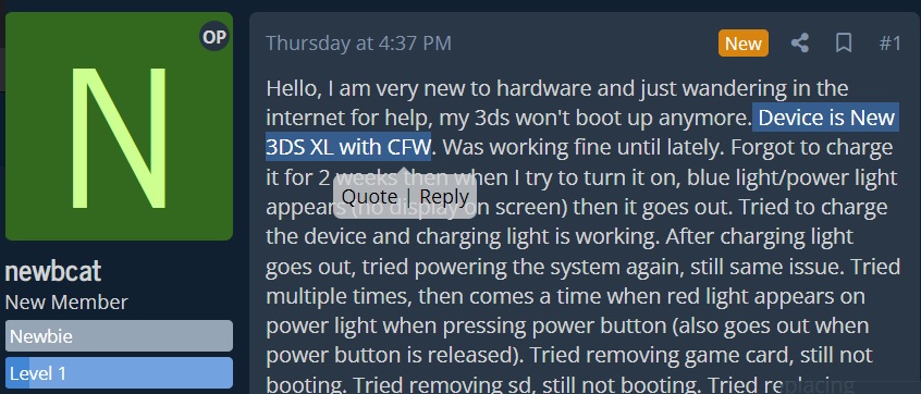

Hello, I am very new to hardware and just wandering in the internet for help, my 3ds won't boot up anymore. Device is New 3DS XL with CFW. Was working fine until lately. Forgot to charge it for 2 weeks then when I try to turn it on, blue light/power light appears (no display on screen) then it goes out. Tried to charge the device and charging light is working. After charging light goes out, tried powering the system again, still same issue. Tried multiple times, then comes a time when red light appears on power light when pressing power button (also goes out when power button is released). Tried removing game card, still not booting. Tried removing sd, still not booting. Tried replacing battery with new one, still not booting. Watched and tested fuses, has continuity, still haven't tried reflowing because I still have no heat gun. Tested diodes, red , orange/yellow working but blue very faint light. I am planning on buying power board but am wondering if the blue diode may be the one causing the issue and if I can just replace it? (Because power board so hard to find around my area and the ones online are so expensive). Is the blue diode included in the things 3ds checks before it can boot? Thanks for those who will answer and Godbless

You didn't answer the question. Is it modded?

Doesn't need to answer something he already stated in the first post
