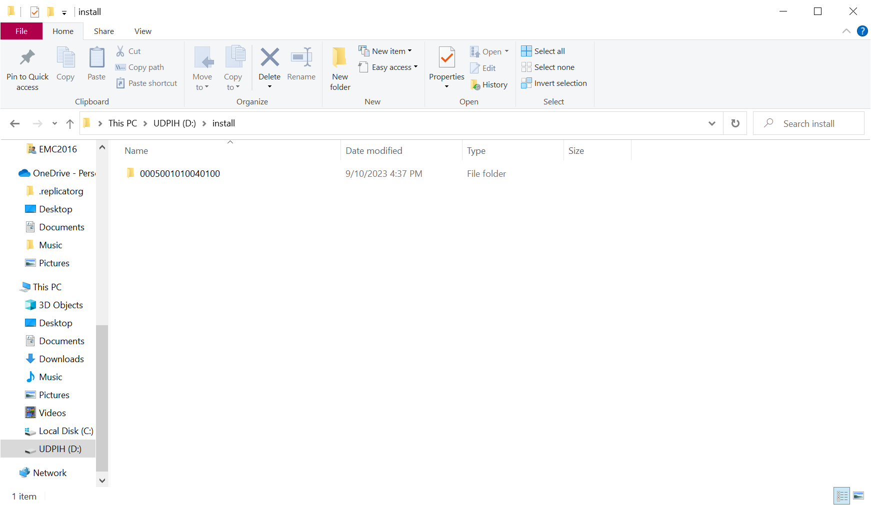

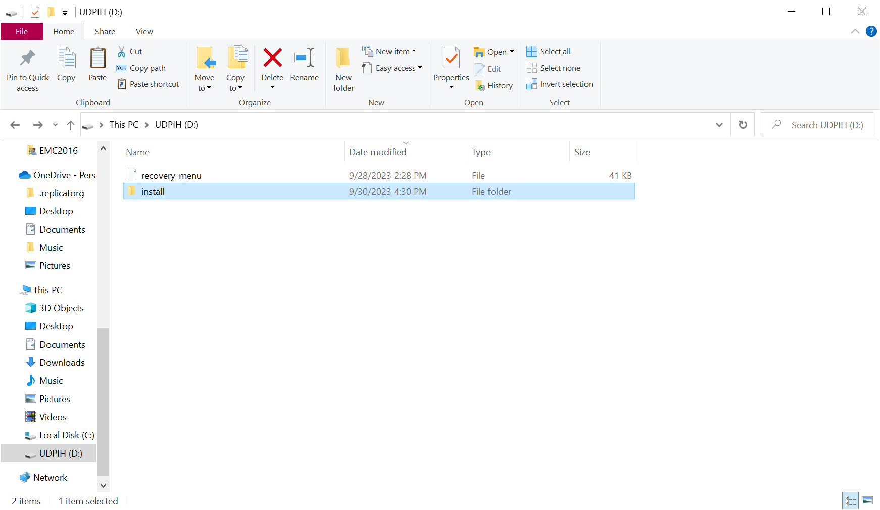

I'm assuming you mean the the "Install WUP" option in the recovery menu? I created an install folder on the root of my SD card and placed the mlc title for the menu in there, but it says "Make sure to place a valid signed WUP directly in 'sd:/install'", which I did, and in red text it says "Failed to get install info: fffbf3e2". Am I doing something wrong?
Also, just out of curiosity, what does WUP stand for? Wii U program?
I've attached two screenshots. One shows the root of the SD card, and the other shows the contents of the install folder.

which recovery do you use? If you use the original form Gary, you need to place the files directly into the install folder. If you use my fork that should be fine.

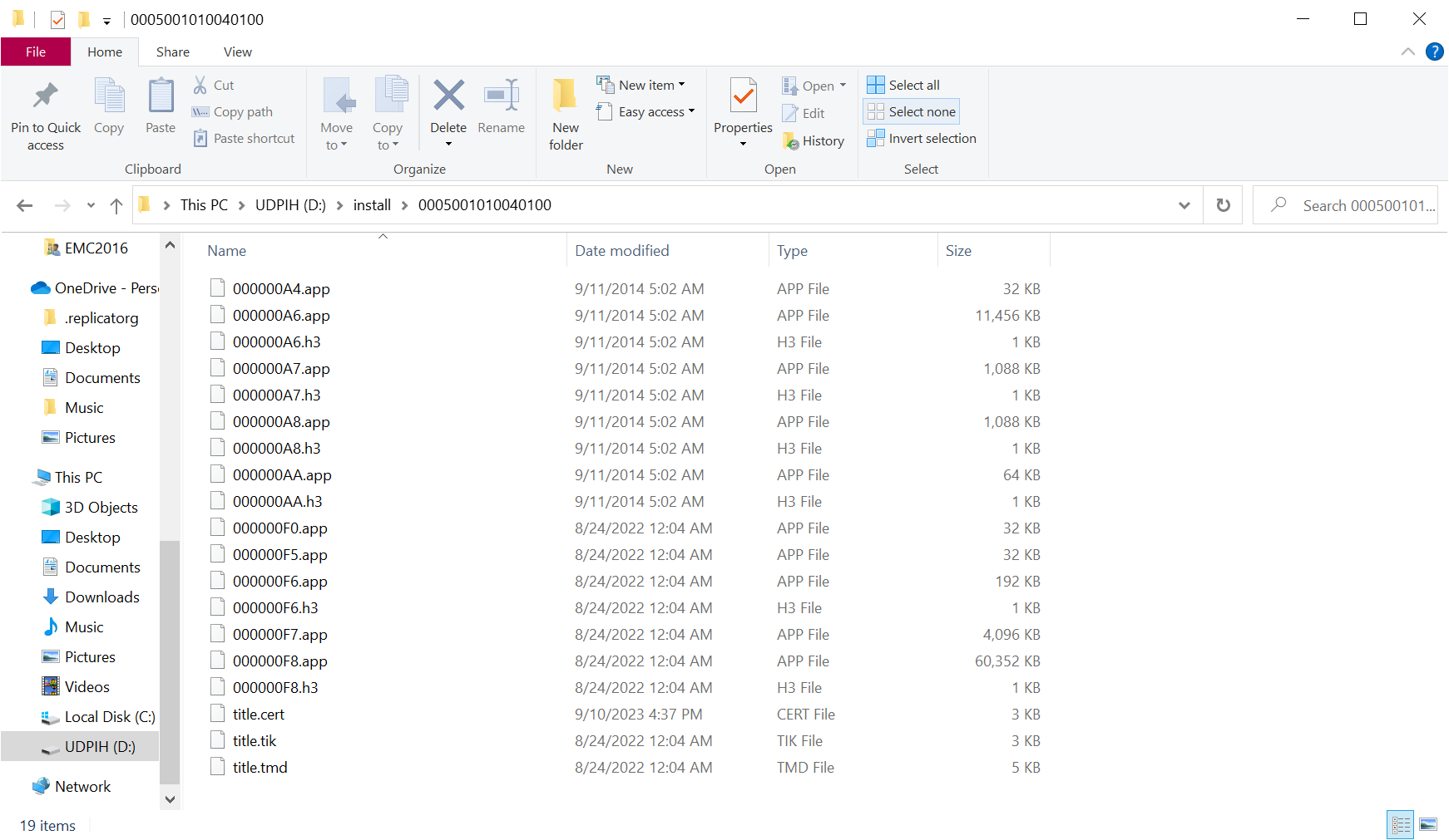

How does the content of that folder look. Does it have title.fst, tilte.tmd and so on?
I'm using the original one from Gary. It had been so long since I used UDPIH that I freshly downloaded everything. I'm not sure if your fork has been posted on this thread. It's possible it was months ago, but I don't recall.
It looks like the folder contains everything, but I've attached a screenshot of it for you to take a look.

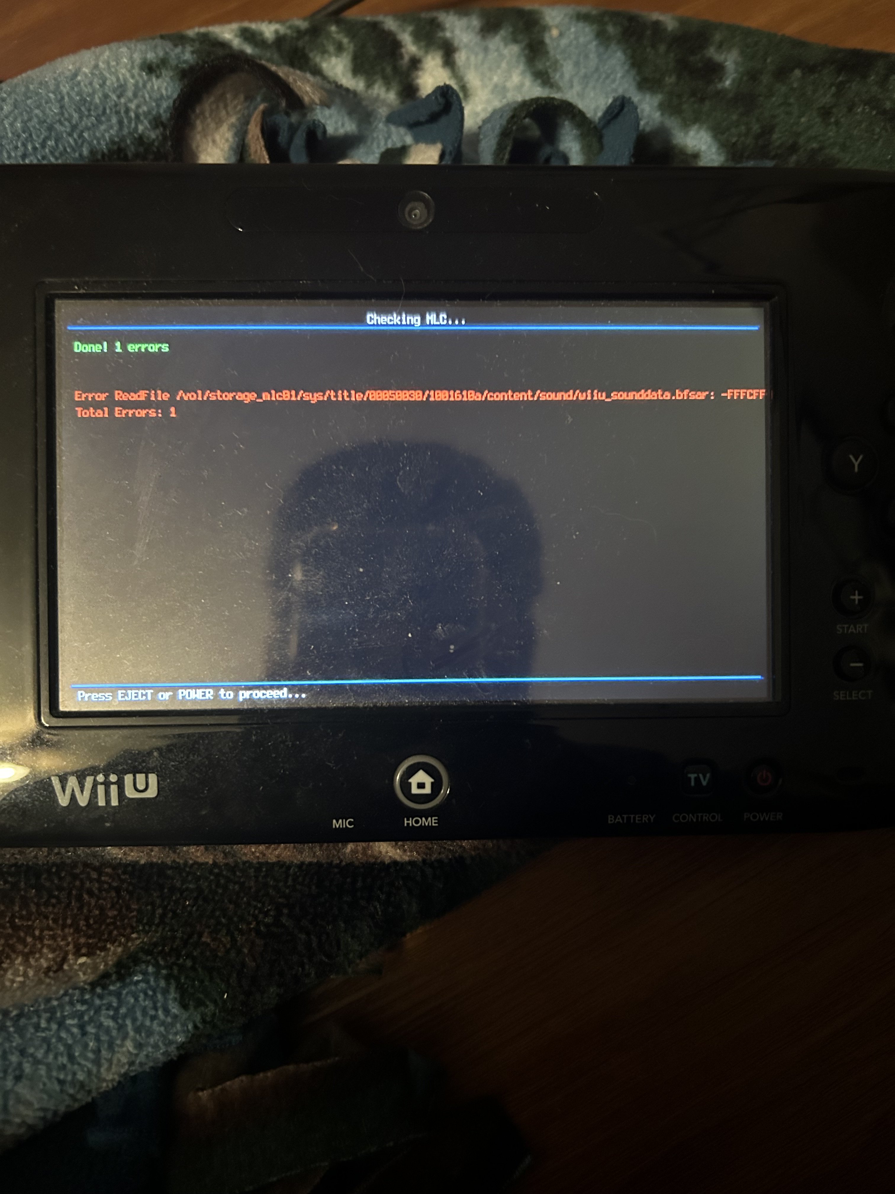

I did the install and then checked both the mlc and slc using the recovery menu. I got one error with the mlc, which I’ve attached a picture of. I assume the fix would be to remove that title like I did with the menu, and then reinstall it.
slc have no errors, so everything is good with that.

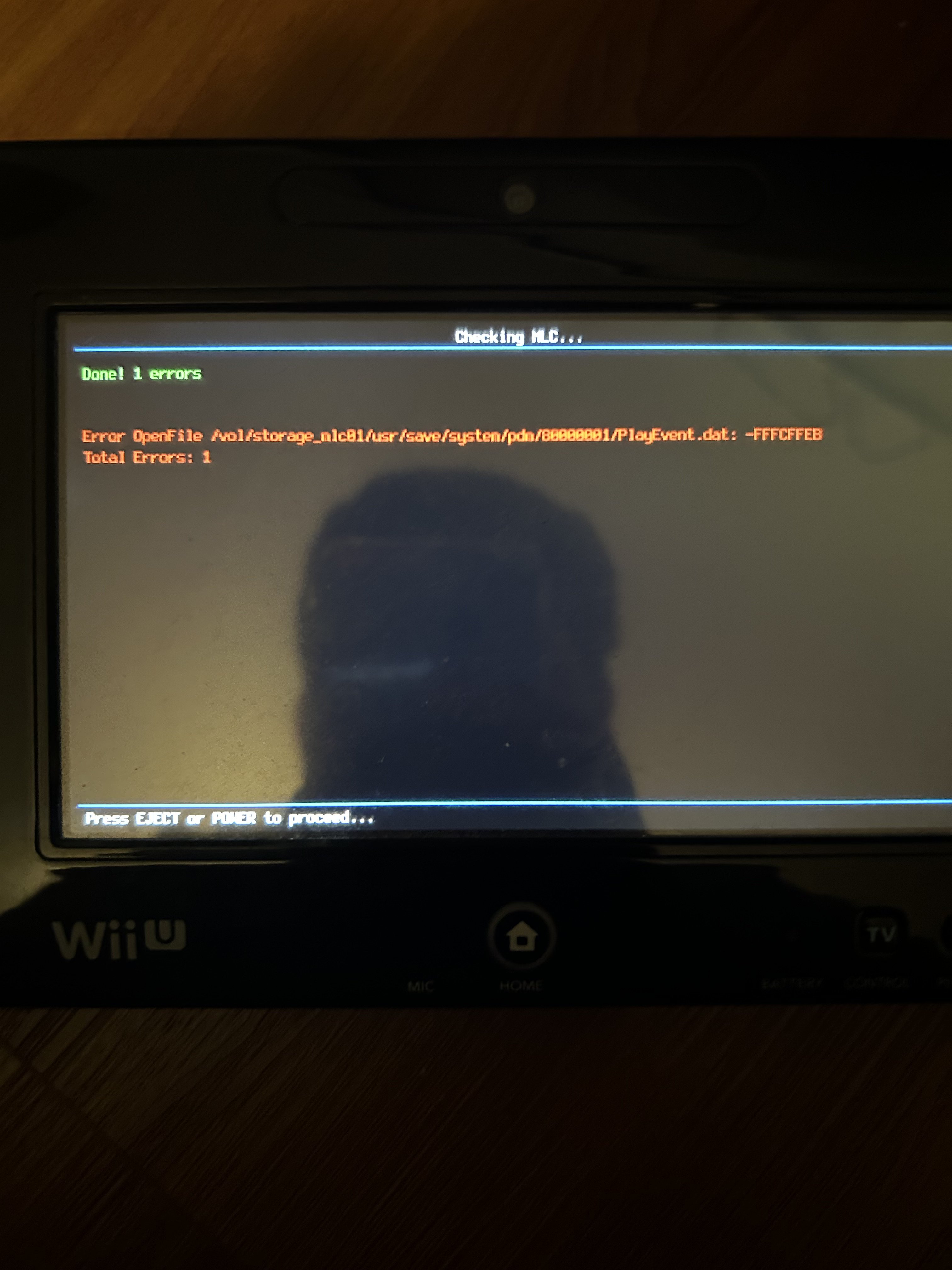

Went ahead and installed that title. That error disappeared, but now there’s a new one that appears to be related to save data. I’ve attached a picture of the error.
Nah, that is fine, it just couldn't open that file, because it is already opened by some system process.

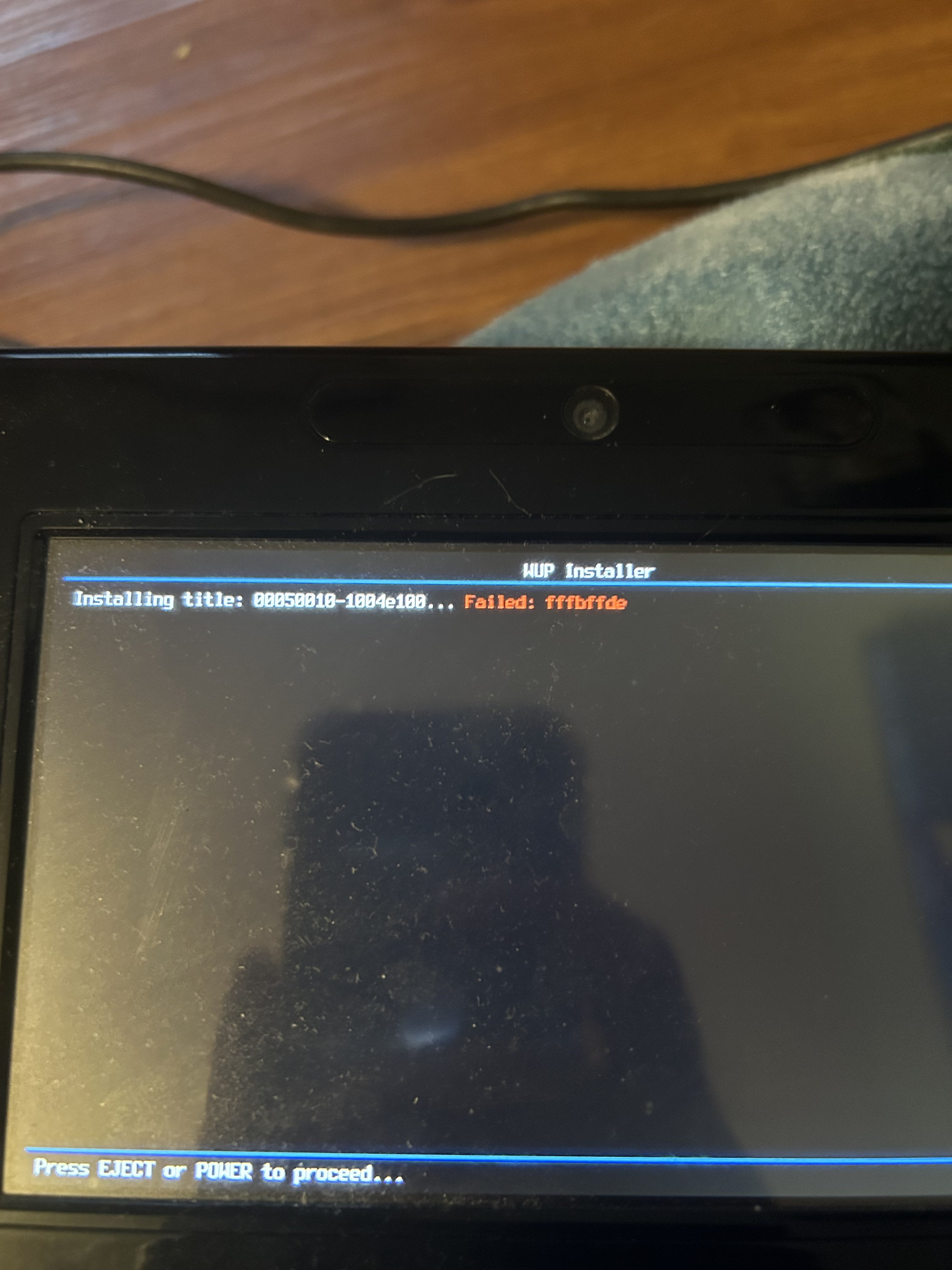

I got a failed message when trying to reinstall the Health & Safety. Perhaps it’s corrupted and needs to be manually removed?

then delete it via ftp. You can also use that to delete the other folder we moved away.
Or maybe its better to start from scratch by using the wafel_destroy and then set it up again fresh, then we can be sure that it is clean.
In addition to the wafel_destroy you might also use the laptop with the built in cardreader and linux to discard the content of the card, so it s completely erased.
Maybe you can use this also with Windows, but I never tried it personally: https://github.com/tenox7/disktrim just be carefull and don't erase your SSD
