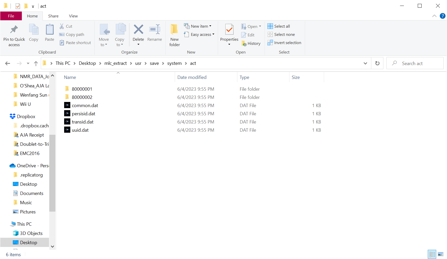

I have two users in the old dump, which should be the correct amount (one is me and the other is my brother). It may be unneccesary, but I have attached a screenshot of the folders. Should I try placing those user folders into the appropriate location on my Wii U via FTP, or is there something else that needs to be done?

No don't copy this folder, that is only the profile, but not the game saves. The game saves are in usr/save/00050000
There is a subfolder for every game and that has then subfolders for each user.
I would recommend you launch all the games first on both users, so they create new save data and then you copy the old save data over the new. First launching the game to create the savegame ensures that the quotas are set up correctly.
I’ll give that a shot. I guess what I was meaning to ask with the last post is if users could be transferred over. I’m not sure what exactly is stored in the user folders, but I would assume stuff like their Mii and settings, among other things.
You would overwrite the users on the console, that should be fine. You can try one user, see if it works and then do the other
