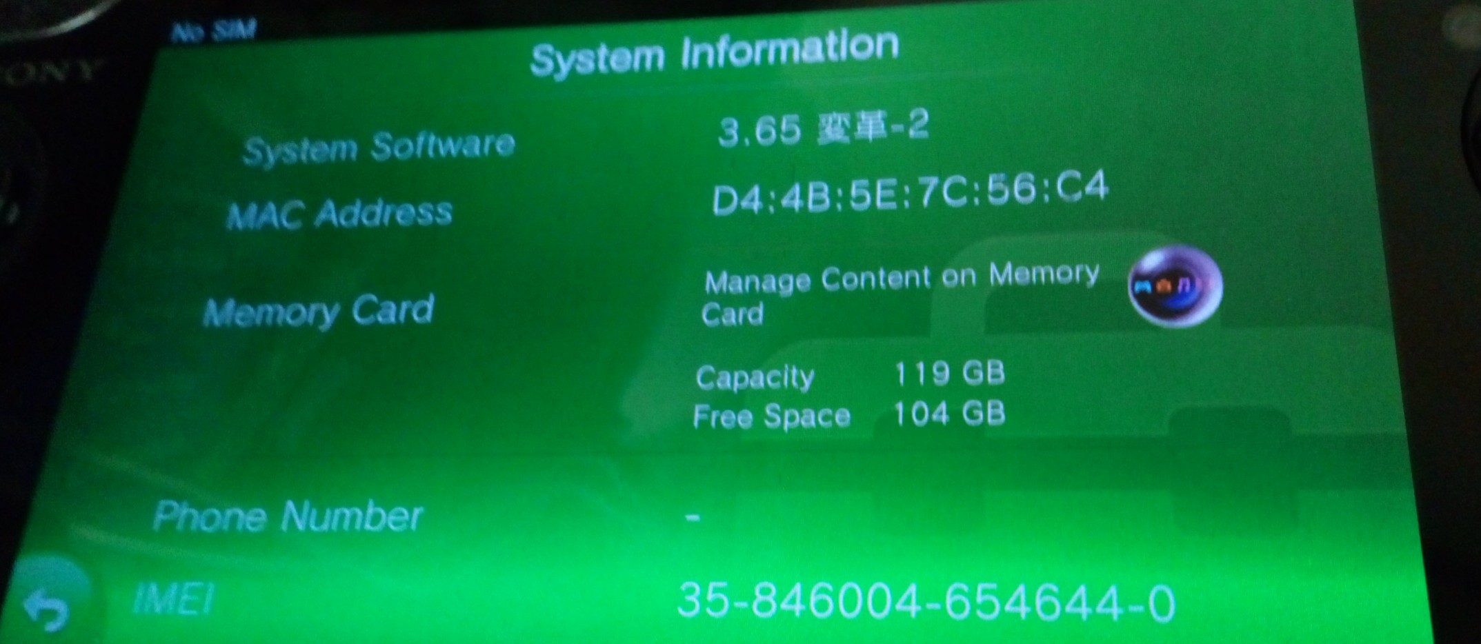

3.65 something-2
I suppose the first step is to undock the microsd. Bad idea to just remove it, right? I should first change the setting that tells the Vita to treat the microsd as a Vita memory card. I just gotta remember where it was..
After that it ought be pretty simple I guess. Just deactivate my psn account and reset.

3.65 something-2
You need to remove enso if you installed enso and then do a factory reset.
