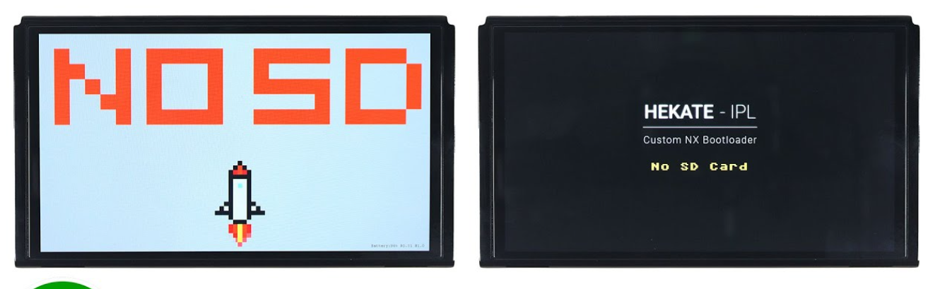

So how do I know if the guy installed the HWFLY chip correctly? What screen should a stock chip display with no micro SD card inserted?
To my understanding, if the chip is correctly installed you should flash the latest version of Spacecraft NX then add Hekate to the micro SD card, make a NAND backup and go from there. Is this correct?
If it's working fine, you should see an error screen like this, stock firmware on the left, hwfly-nx firmware on the right:
You can flash the chip before installing, doesn't really matter. From my experience some consoles (especially those with toshiba emmc, some hynix emmc) work better with stock firmware, where others (especially those with samsung emmc) work better with hwfly-nx firmware and would instant boot every time. So you might need to test yourself to see which firmware works better for your console.

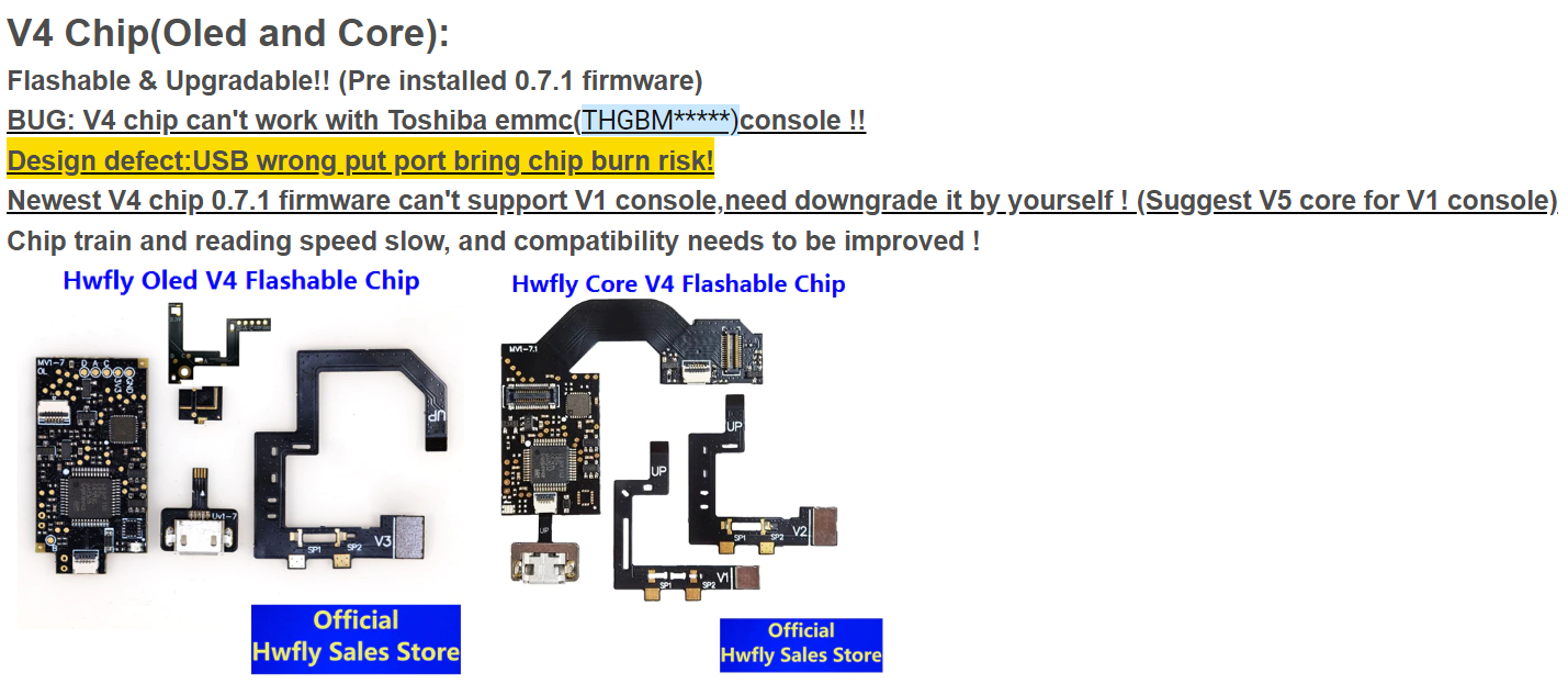

I reread the listing for the HWFLY chips on Ali Express and it says that the 4.0 chips have a defect in them which can brick them when you flash the firmware. Is this the problem where you have to make sure the side labelled "up" on the USB ribbon is pointing upwards or is it something else?
I think op's referring to this "bug" from hwfly's aliexpress page:
It means if you plug the usb ribbon cable the wrong way (upside down) it will fry the usb port on the modchip. However the chip should still glitch just fine. v4.1/v5 chips adds some protection circuit in case you plug the usb ribbon cable upside down.
However, other claims they make about v4 chip is wrong and misleading. V4 chip does work with Toshiba emmc, I just installed one last week. Doesn't have the fastest glitching time like samsung but it works. My seller on taobao also confirmed this. As for v1 support, I think you need to use their original firmware, not hwfly-nx firmware.
According to my seller on taobao, v4.1/v5 chips are made by another manufacturer and has more problems than v4. They don't even sell v4.1/v5 chips on taobao, just on aliexpress. So I'd suggest avoid these v4.1/v5 chips and stick wth v4.
(Btw I'm buying directly from taobao because it's cheaper and I can pick up other stuff like joycon sticks, shells and other accessories and combine shipping, much cheaper and faster than aliexpress)
