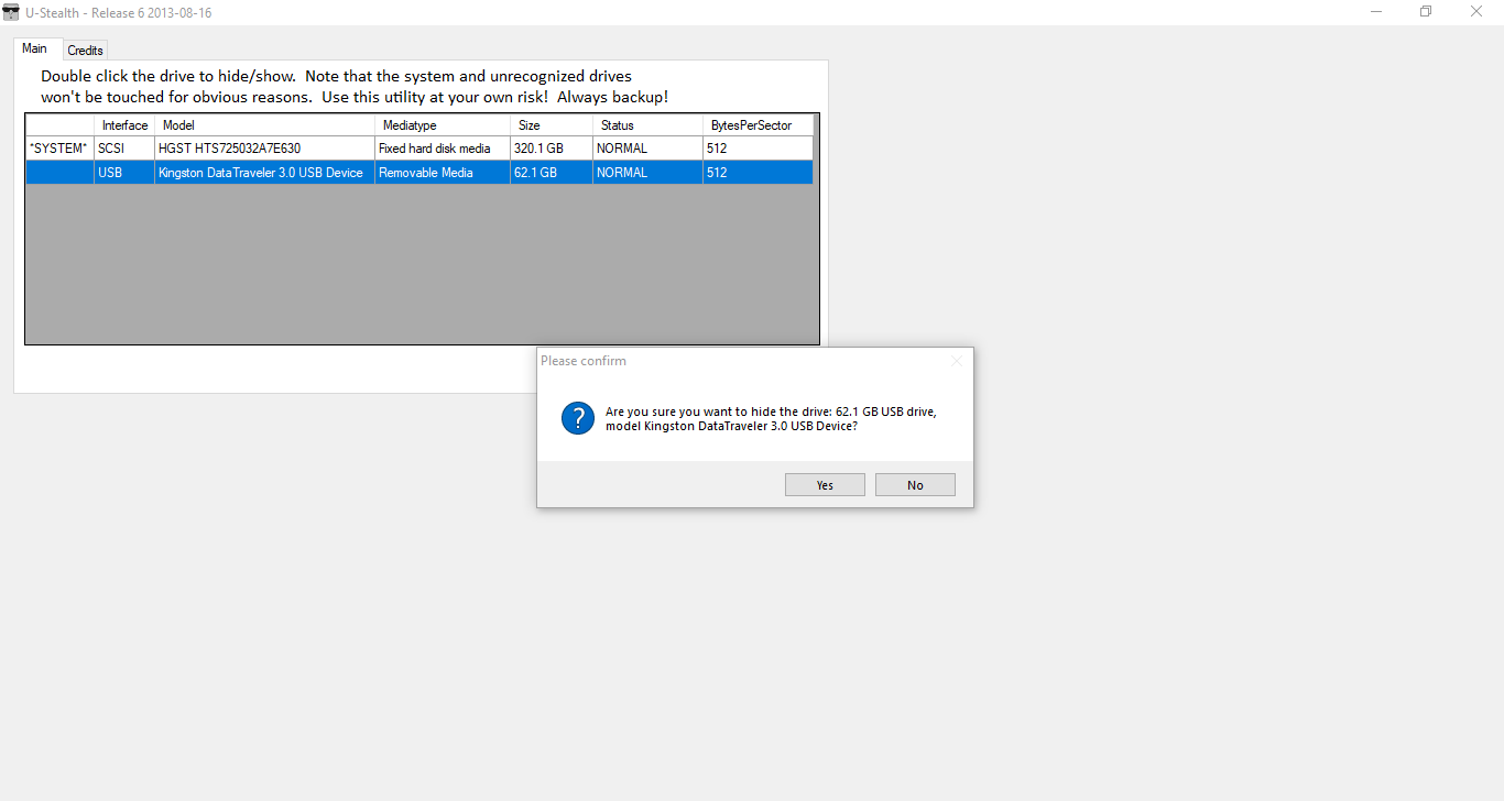

I know that it's probably my fault but I don't know what I did wrong but when I tried to hide my USB it worked but I can't show it again? Can anyone help please on how to show it again? A video would be nice too please? It's a Kingston G4 Data Traveler 64 GB Drive
should be just clicking or double clicking the drive that says HIDDEN. then, remove the drive from the computer and plug it back in.
Sorry but the problem is that it's thinking that it's not hidden but it is but won't let me show the USB. Is there any other way to make the USB shown again? This is what I'm taking about:

it says to try R7 if R8 works. R8 works for me, personally. there's also the possibility that it's not compatible for some reason. I'm using I think a wd blue. I put it in an enclosure with a toggle switch, and I think it's a wd blue or black, but I'm think it's a wd blue (can't remember).

Didn't Work, so is my USB dead then?
well, there's a couple commands above somewhere that shows how to stealth the drive via terminal. that's the only other thing I can think of. if you don't know how to do that, try another drive or something.
Another thing what I mean is that when I hide it, it thinks the USB is still normal or shown, not hidden, also I got this information from this video

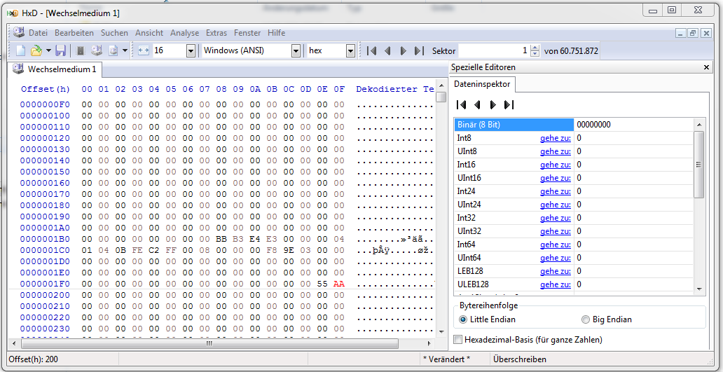

you need to change the last byte of mbr from AB to AA

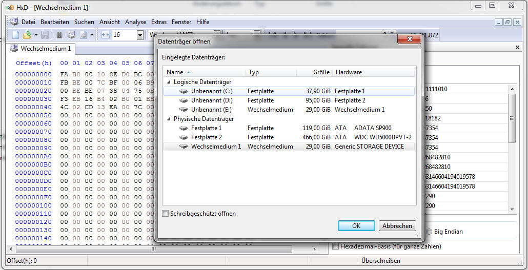

you can also use dd for windows, you just need to copy the first 512 bytes from the usb device to the pc, change with regular hex ediotr and copy back.
http://www.chrysocome.net/dd
ensure you use the right device and also maybe make either a backup (of your usb device) or do some sort of test before copying back. also ensure you dont mess up your pc hd

did you uncheck read-only when selecting the device?

yes, i did uncheck read-only

maybe you need to start as admin to get needed permission.
I only used win 7 and didnt need to do this, so not sure
maybe windows is accessing the drive. If you insert the device the windows prompt which wants to format your drive to be useable should show up. Did you abort the dialog? Else, maybe win blocks access ?
