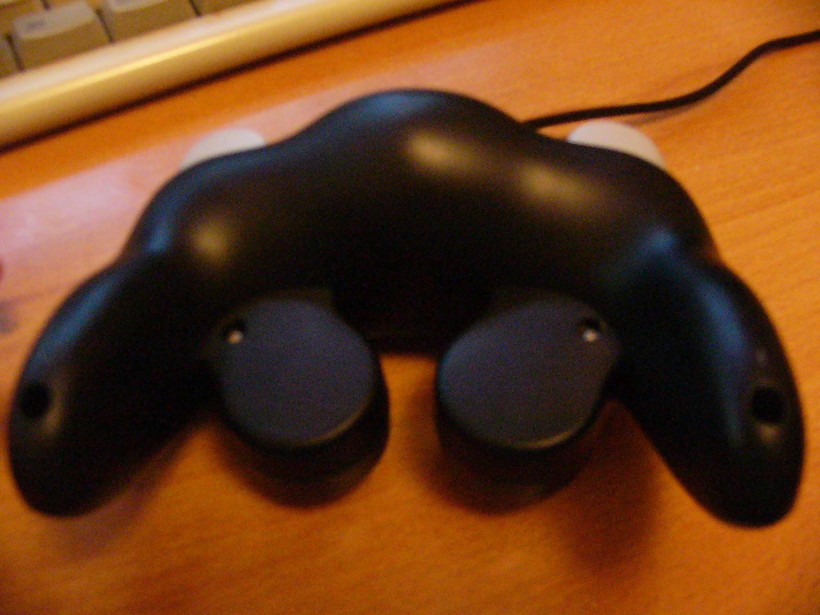

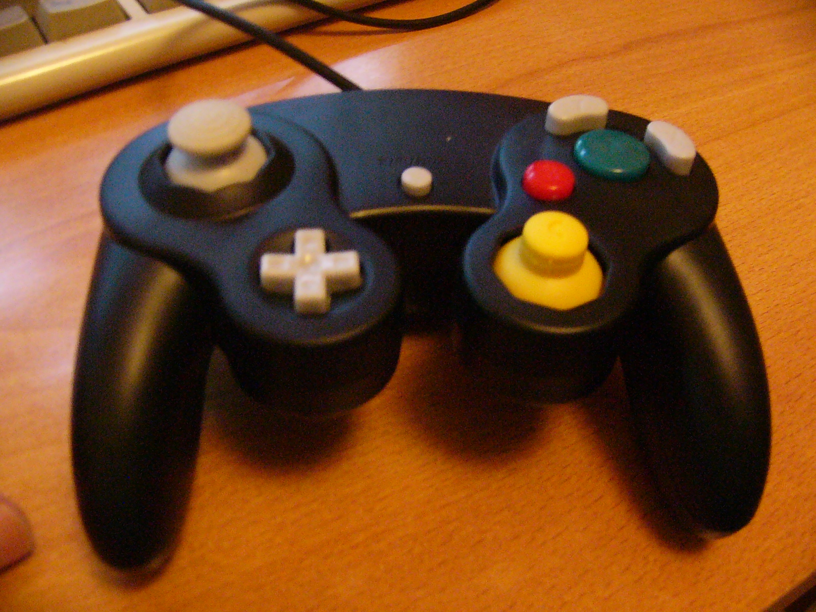

Sorry,that was my Fault,I do not read correctly.Mine is an Gamecube Controller with the Gamecube Connector.
