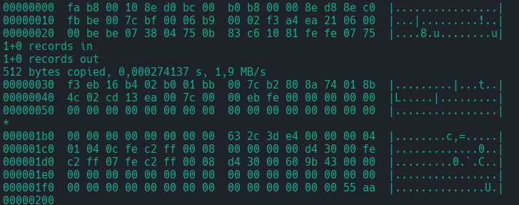

Hm it looks good to me. Maybe send me the MBR (first 512bytes) and I can have a look if something is up with that.

mbr dump:
for syslog of aroma: which path does it have?
