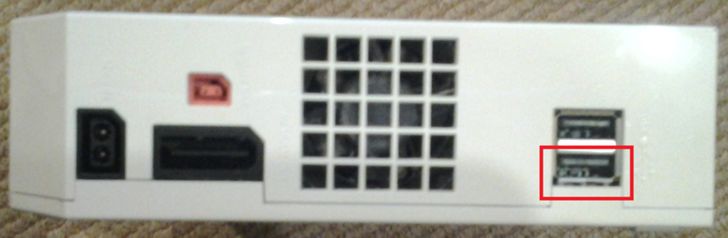

Is is plugged into the correct Port 0 ?
Thank you.:)
USB Loader GX was the latest version the other day.
WD My Passport (some four-digit number), formatted as WBFS.
I had it plugged into Port 0, however -- I take back the however (but I did end up switching to Port 1; I'll try switching back).
