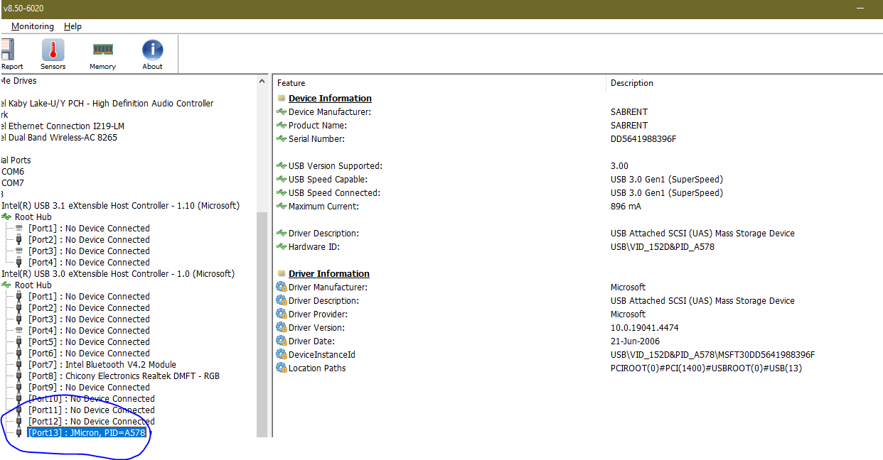

Is the cluster size 32KB or 64KB? You could try changing it between one or the other to see if it helps.
Were the games added to the drive via the loader itself, or via TinyWiiBackupManager?
I don't suppose device manager or some software (e.g. AIDA64, HWiNFO) can confirm the JMicron chipset? If you were using a Linux distro the lsusb -v command might work.
https://sabrent.com/products/ec-uasp
The Sabrent website links to a firmware update, which suggests that the enclosure normally comes with the JMS583 chip. Two other people (one from the UK and one from the US) have confirmed that this enclosure normally works. However, I think they were both using HDDs.
Cluster size was 32 KB, I tried out 64 KB, which did not solve the issue.
I added the games via "WiiBackupManager_Win64.exe", build 78, using wbfs. That way, it also worked on SD card and other devices.
I checked via HWiNFO, see the attached screenshot. If I (and by that I mean my trusty AI :P), PID=A578 might mean it is the JMS579 instead of the JMS583 you mentioned.
I then tried out the same thing with a "Internal 2.5 Inch SSD SATA III Top, 256 GB, 520 MB/s, Black", and this time it worked without any issue.
In other words: Stay away from "Fikwot FX815 512GB 3D NAND 2.5"!
Thank you for your help!
