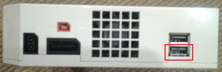

First Thing to check please,you have formatted your USB Stick with FAT32 and has only ONE Partition on it.
Then,of course,you have plugged it into the correct Port 0:

2. I used the right USB Port
3. USB Stick is Fat32 only 1 partition, only Wii and GC Games (everything else on SD Card)
