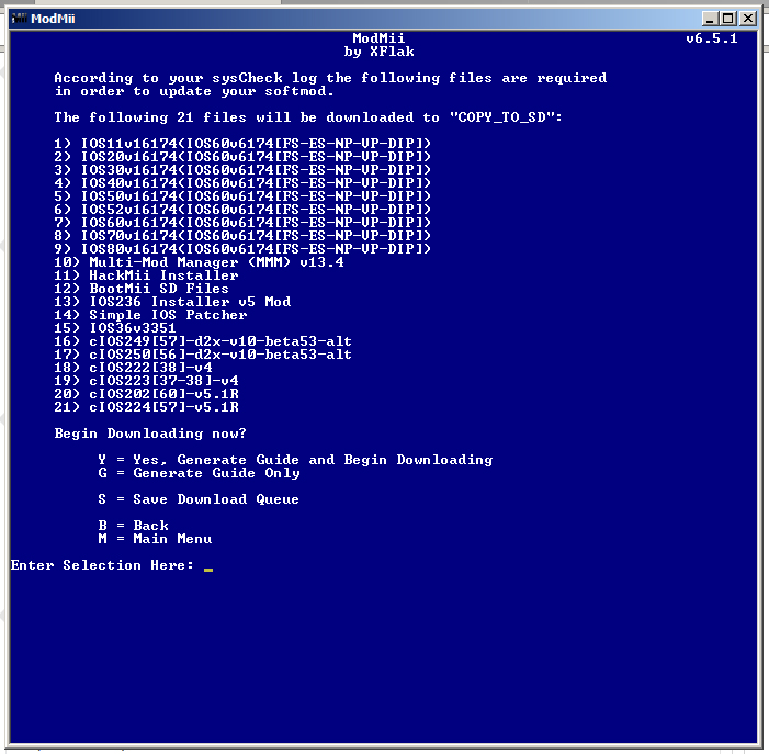

It is recommende to update
- the Points 13 - 15
IOS236 - Important !!
This IOS is needed to install other IOSes.It is a hacked version of Nintendo's IOS36 that allows you to install other IOSes.
IOS36 - Many Games and Homebrew based on it.
- the cIOSes frorm Point 16 to 21
These are for the Games Compatibility and USB (Equipment) Access needed ones.
If you do not have an .wad Installer then you also need point 10.
Are you familiar with ModMii and updating cIOSes ?
https://gbatemp.net/threads/modmii-for-windows-official-support-topic.207126/
Good luck.:)
Good luck.:)

Updating your Wii using ModMii is not so tough as it seems.:)
http://modmii.000webhostapp.com/usage.html
After careful reading through this Guide please get the PC Tool ModMii from here:
http://modmii.000webhostapp.com/home.html
(The English Version I suspect. :D )
Install it with Administrator rights on Windows (works with Windows 7 and 10 all versions).
Then you have two shortcuts (I only use the "classic" non Skin Version).
Drag and Drop YOUR sysCheck.csv (please rename yours simply from sysCheck.txt to sysCheck.csv) on that shortcut and the ModMii update Wizard with the suggested Updates opens.
You can download ALL recommended IOSes/cIOSes/Apps or use the Advise from above post.
You also get an Manual/Readme Guide downloaded which opens a new Browser Window during the Download.
Please read it through in peace.
The MULTI MOD MANAGER is the Application on your Wii with that you can install the IOSes/cIOSes which are WAD files.
The IOS236 Installer is also an Application which do the Job for you (as it says - Install IOS236)
For the Simple IOS Patcher the same.
I do not know how you Softmod your Wii but it seems that you have the PRIILOADER installed.
This is a simple Brick Protection and a Life Saver for you and your Wii if something goes "wrong".
If you Power ON your Wii by pressing and holding simultaneously the RESET Button you can access the Application.
The downloaded
IOS36 and
cIOSes from Point 16-21 has to be installed with the MULTI MOD MANAGER.
Thats the Theory.:D
Please take your time, read everything in peace and quiet and do nothing in haste and hurry.
If you NOT SURE please ask here,there are many Users with Knowledge and helpful.
Good Luck.:)
