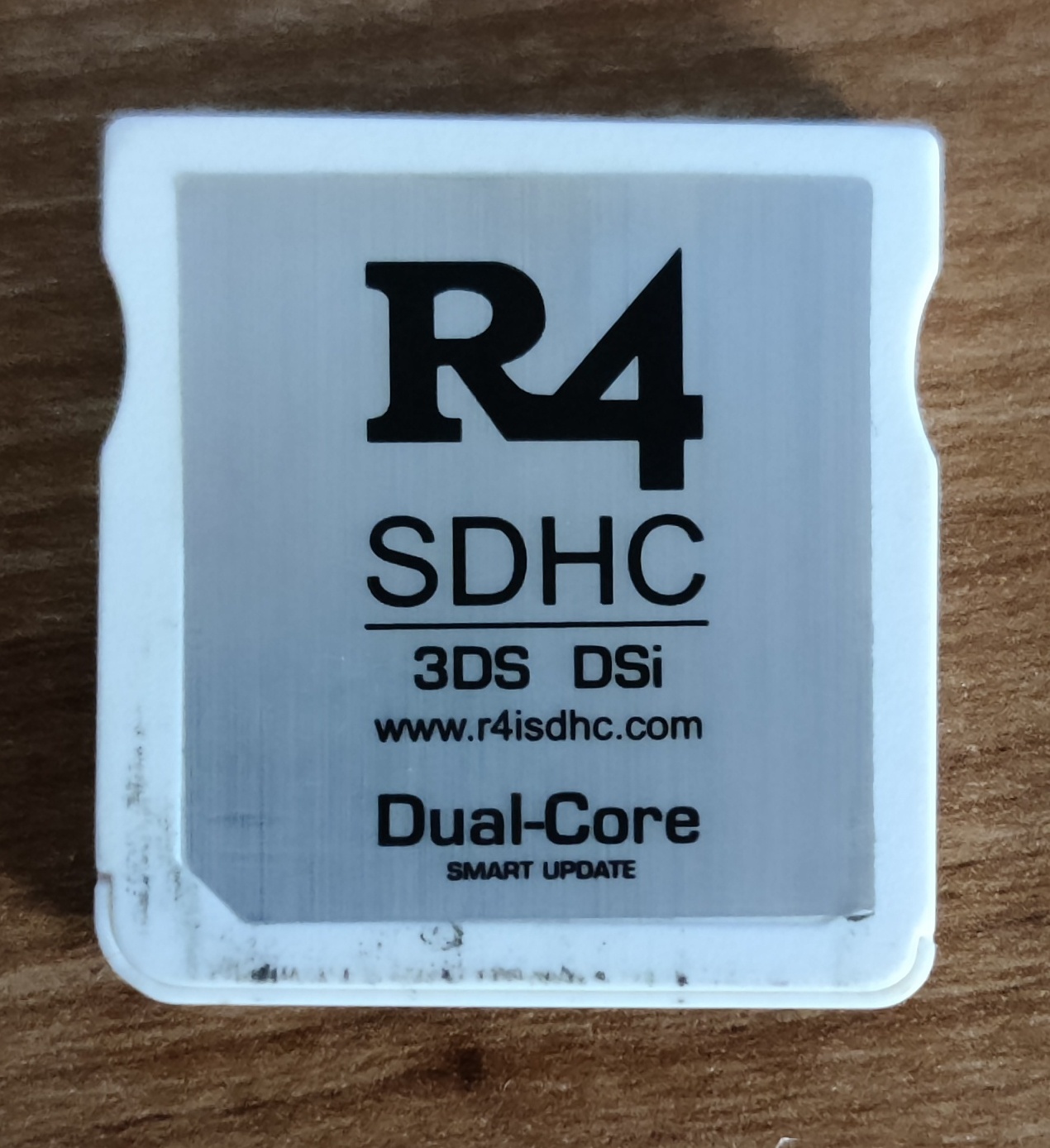

I accidentaly bricked my r4 installing the wrong kernel (There were an error that said the kernel wasn't original. When I restarted the ds i see the "no cart inserted" error). I've tryed reinstalling the firmware (Find via wayback machine) with hotswapping in NDSL (It stops at eresing 0%) and in NDSIXL (It completly skip the eresing progress, it succed but still not working). I've tryed also with TWL menu (Same as howswapping with dsi xl) and unlaunch (same as hotswapping with ds lite). Do you know any other method to unbrick it?
That's the card:
R4iSDHC white 2011, can't attach link

Unfortunately, there isn't any known way to unbrick those carts after they're bricked by YSMenu (or the r4isdhc.com kernel it sounds like?)
Your only option is to just buy a new cart. I recommend taking a look at the r/flashcarts wiki for what's recommended currently.

When they're completely dead they don't show up in the menu anymore, where the wrong kernel will simply show an error.
It's not an intentional brick afaik, it's simply that the card happens to use the same commands DSTT clones use for "read SD" as "write flash" or something like that, which means when YSMenu or such tries to read the SD it actually ends up writing garbage into the flash, killing it. And without any way to load it anymore there's no way to recover it.

Apologies for the necrobump, but this is very useful. I have provided a link as to where you can find a flash backup for this card.
https://gbatemp.net/download/r4-sdhc-dual-core-no-year-new-bubble-r4isdhc-com-flash-backup.39038/
You will need to desolder the flash chip from the board prior to writing the backup, this sadly doesn't work when an IC clip is attached. Your card is based on the many R4DS Pro clones.
