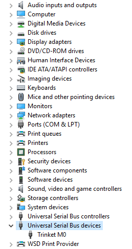

Nup, just normal Windows 10 Pro and a regular run-of-the-mill USB 2.0 port. Device manager says the Trinket is there under USB devices. If I unplug the Trinket and plug it back in, the bottom left LED doesn't breathe until I press the reset button. It just stays dimly lit, that helpful at all?
Nup, just normal Windows 10 Pro and a regular run-of-the-mill USB 2.0 port. Device manager says the Trinket is there under USB devices. If I unplug the Trinket and plug it back in, the bottom left LED doesn't breathe until I press the rest button. It just stays dimly lit, that helpful at all?
Your Trinket seems fine. Check device manager and see what you have in there
It's there and everything is apparently fine according to Windows.
Strange. The chip is fine.
And you have no SWITCHBOOT drive... Got to be a problem in Windows. Has to be.
